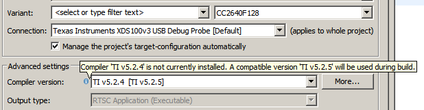

due to my problem I have an installation of CCS, where TI ARM compiler 5.2.4 is not installed any more.
I can't install 5.2.4, because of
In another thread I asked, which compiler you recommend and you responded "5.2.4".
What is the best way to go? Try to install 5.2.4 (uninstall 5.2.5 before) or go with 5.2.4? Or even 5.2.6?

  • Hello Harald,
    You can use the latest TI Compiler that is updated in CCS v6.1. 5.2.6 should be fine.
    If you have a problem, can you list the exact modifications to the reference project you are using? Do the default projects build w/o error?
