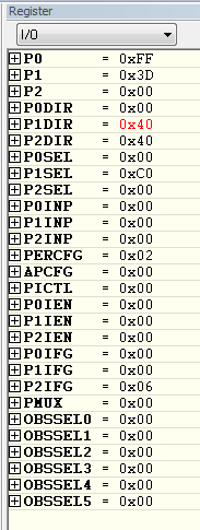

  • I'm using the following settings:
    1) Preprocessor defined symbol used is HAL_UART_DMA=2.
    2) I added a line of code to set P1_6 today (see below)
    3) A scope probe is set at the Keyfob's Buzzer [B2:1] to monitor the P1_6 output.
    [--Begin code--
    static void HalUARTInitDMA(void)
     halDMADesc_t *ch;
    #if (HAL_UART_DMA == 1)
     PERCFG &= ~HAL_UART_PERCFG_BIT;    // Set UART0 I/O to Alt. 1 location on P0.
    #else
     PERCFG |= HAL_UART_PERCFG_BIT;     // Set UART1 I/O to Alt. 2 location on P1.
    #endif
     PxSEL  |= HAL_UART_Px_SEL;         // Enable Peripheral control of Rx/Tx on Px.
     UxCSR = CSR_MODE;                  // Mode is UART Mode.
     UxUCR = UCR_FLUSH;                 // Flush it.
     P2DIR &= ~P2DIR_PRIPO;
     P2DIR |= HAL_UART_PRIPO;
     PxDIR |= 0x40;                      // #: [30Nov2015] Setup P1_6 as output
    --End Code--]
    After HalUARTInitDMA() executes this is the status of the registers.
    Is the setup correct?
