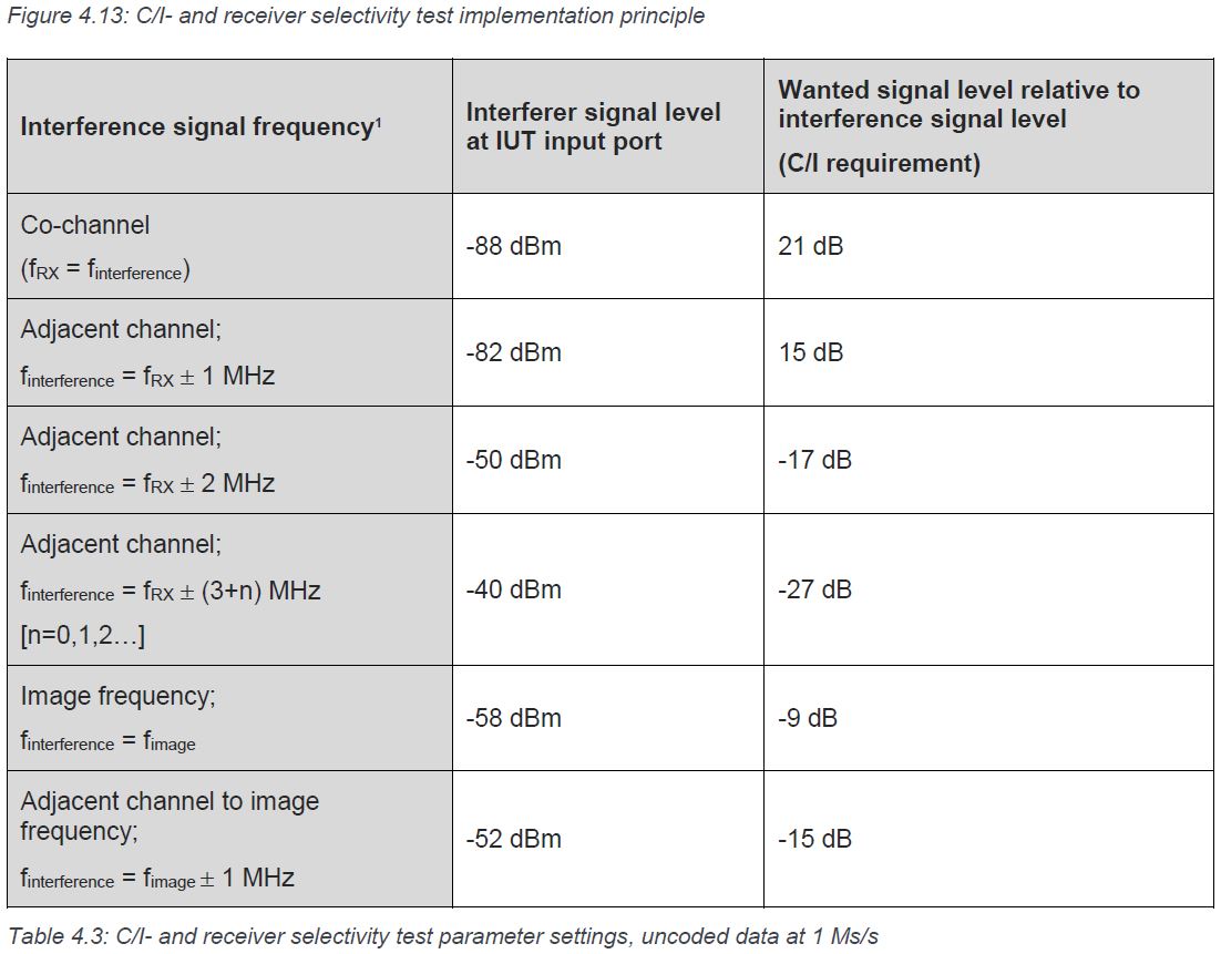

Our customer did the CC2640 BLE BQB test, but in RCV03 test (BT/EDR CI Performance), channel 2 is always failed. Below is some of the details.
Could you give some advice about this?

They use CC2640F128 5x5 package, and RF internal bias with differential RF output.
In IAR, I use CC2650DK_5XD for 5x5 package. But for RF internal bias with differential RF output, there is only CC2650EM_5XD and CC2650EM_7ID, and now I used CC2650EM_7ID as RF configuration. Does this set have problem? If so, could you provide CC2650EM_5ID configurations?
Now we use Launchpad CC2650 v1.1 and Launchpad CC2640R2F v1.0 do the same test, they have the same results on RCV03 test too.

I just ran a CC2650 LaunchPad with BLE Stack 2.2.2 on our tester here. I did not see any failures. See attached results.
