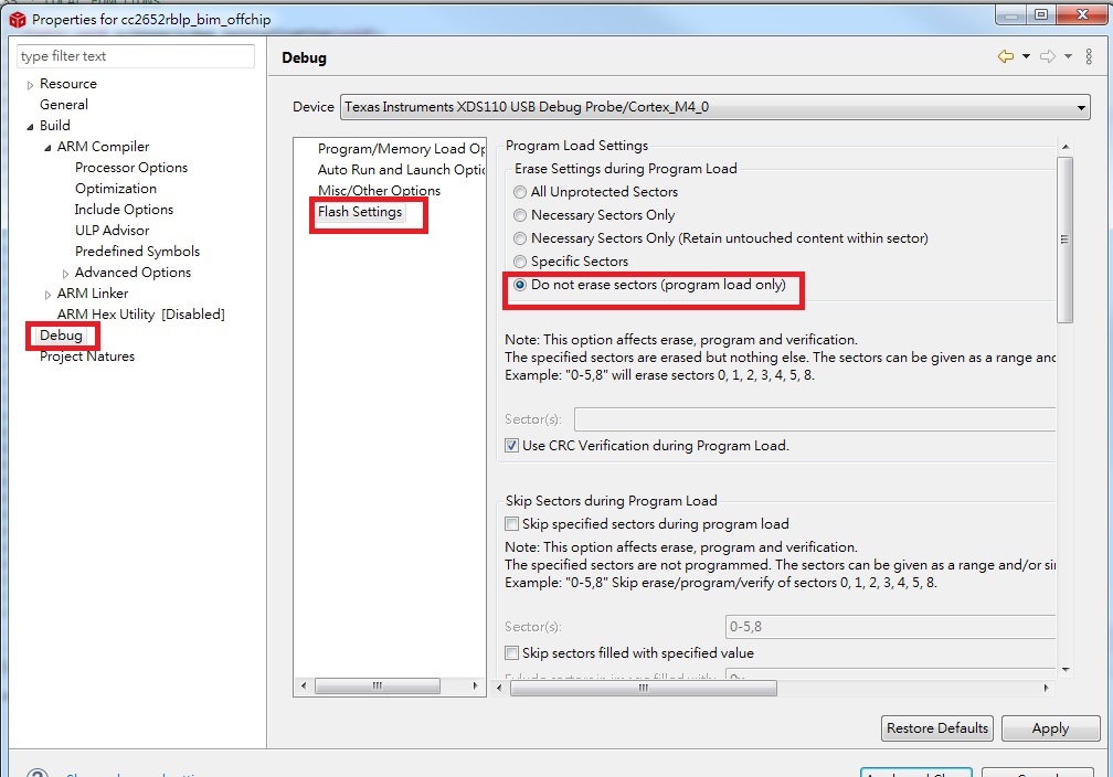

CC2640R2F: CC2640r2 works while connected to debugger but not while connected to external power
Part Number: CC2640R2F
Other Parts Discussed in Thread: CC2640,
This is a continuation from this thread.
After loading the STACK using the debugger and CCS, I load the APP via UniFlash5.3.1, and then load the BIM via CCS as suggested in the documentation. I disconnect the target and power it from external power. Initially it works - connects to my phone via lightBlue and I can interact with it via UART-to-USB bridge (not integrated TI). I disconnect the BLE connection, the device begins to advertise. I connect again, but I only have access to advertisement info - no chance to interact with it. I disconnect and then the device no longer advertises. Reset doesn't restart the device. By simply disconnecting the external power and connecting the debugger (I did not flash a new image, just reconnected the debugger) the device magically operates perfectly. I suspected that the device might be power differently via VCC on JTAG header, so I supplied 3.3VDC to pin 10 on the JTAG header. This worked the same was as connecting to external power. I've attached the schematic for reference. What's magic about the debugger connection?
Thanks for the help.
Patrick
