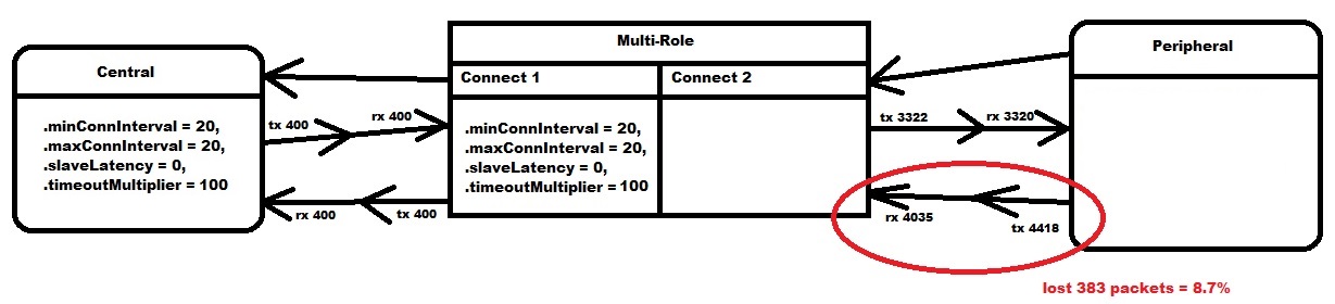

I have a problem with CC2640
I am using a multi-role and two peripherals. My peripheral settings TGAP_CONN_EST_INT_MIN = 20 and TGAP_CONN_EST_INT_ MAX = 20
I count the number of sent packets from the periphery to the multi-role (GATT_Notification returns SUCCESS). And the number of received packets in muti-role.
Some packages don't get through. I tried increasing TGAP_CONN_EST_INT_ MAX but packets are still lost, but in smaller numbers. This happens when multi-role is actively exchanged with other peripherals.
What could be the problem?
P.S. Both connections use MTU_Exchange

  • Hey Ammar,
    Thank you for the ideas.
    I have tried increasing the connection interval, but the problem with packet loss did not go away and transfer speed dropped.
    I tried using only three devices - multi-role, peripheral and central. And I have two connections.
    All projects used SDK 1.50.00.58
    MAX_PDU_SIZE=148
    MAX_NUM_PDU=4
    Connection interval  = 20    (20 *1.25ms=25 ms  >  12.5 + 5*2 = 22.5ms)
    But I see packet loss from peripherals to multi-role (img 1)
    The oscilloscope shows the following (img 2) Here, multi-role transfers packets to central and tries to receive packets from the periphery
    In my opinion it, there are connection collisions
    I don't understand why the multi-role does not update the connection with the periphery after establishing a connection with the central?
    And why the multi-role don't move anchor point for connection event for periphery?
    I try for this Update Parameters Connect for Peripheral. But it has no effect.
    Does it make sense to update the connection parameters from the multi-role for the Central?

  • Hi, Ammar!
    I will try to update SDK for all my projects, but for it need some time.
    >>Do you see packet loss if you disconnect the central device and only connect the multi-role to the peripheral?
    If I power off the central device then packets don't loss between the multi-role and the peripheral.
    When I power on the central device - packets lose
