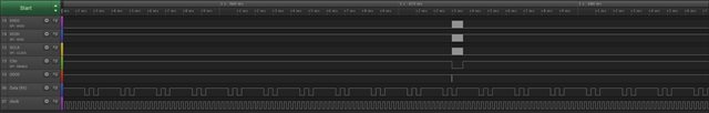

    Logic analyzer plots showing SPI + GDO0 on transmitter and received data and clock (serial mode) on the receiver (receiving 0xF5F5F5F5......)

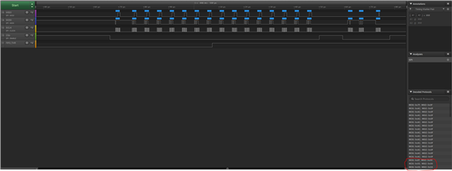

    All SPI traffic will look like this:
    Zooming in on the first 15 bytes being written + the reading of the MODEM_STATUS0 register, wee see that MODEM_STATUS0 = 0x04
    We can also see that FIFO_THR is asserted after 7 bytes written
    After writing 8 x 15 + 8 = 128 bytes to the TX FIFO, MODEM_STATUS0 will be 0x0C (There are 7 or more bytes in the TX FIFO, and it is also FULL).
    and NUM_TXBYTES will be 128 (0x80):
