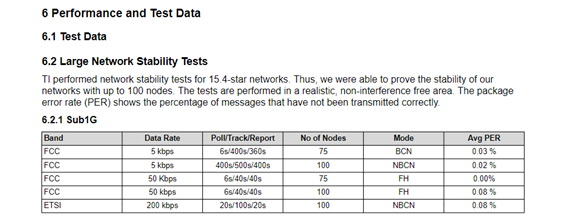

    did you consider using Ti15.4-Stack: https://www.ti.com/lit/an/swra782/swra782.pdf?ts=1726483058458
    In Table 6.2.1 Sub1G you can see the results of our stability test with 100 nodes.
    Does it fulfill your requirements?

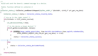

    In our setup, we are actually utilizing the command "Smsgs_cmdIds_toggleLedRsp" to transmit our custom data. When we tried to add the new command and transmit with the "Sensor_sendMsg" API, the data was not received on the collector side (we added the new command on both sides).
    So is there a possible way to transmit our custom data with different intervals? Did you transmit any data between the snsors and collector frequently and observe the results on your setup?

    the procedure to define a custom message and how to implement the sending and receiving is explained in the second lab: https://dev.ti.com/tirex/explore/node?node=A__Ad2.9fPbq0Ip1JEbNHZlww__com.ti.SIMPLELINK_ACADEMY_CC13XX_CC26XX_SDK__AfkT0vQ__LATEST
    Please let me know if you were successful in implementing a custom message.
    Once you followed the labs you can move to the secure commissioning examples (sensor_sm, collector_sm) which implement the secure features described here: https://dev.ti.com/tirex/content/simplelink_cc13xx_cc26xx_sdk_7_41_00_17/docs/ti154stack/html/ti154stack/secure-commissioning.html All the other functionality from the sensor and collector project stays the same so you can in the same way implement a custom message.
    Please note that the implemented trigger for the secure key refreshment should be modified by you to be triggered for all devices by either a timer or message exchange, etc. This is necessary to keep the devices connected.

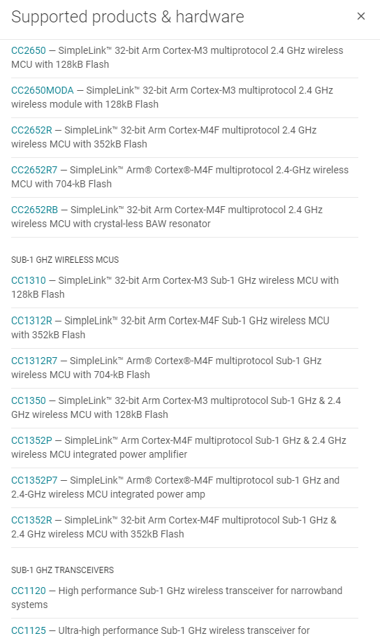

    for the packet sniffer you need to use one of the supported boards:
    Another debugging option is to implement a second UART (https://e2e.ti.com/support/wireless-connectivity/sub-1-ghz-group/sub-1-ghz/f/sub-1-ghz-forum/1415402/lp-em-cc1354p10-adding-uart-interruption-to-wi-sun-coap-project).

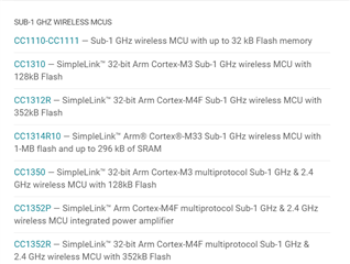

    From your list we could not find the launchpad that we are having (LP-EM-CC1314R10).
    However when searching on online there is a Ti's packet sniffer V2.18.1, which supports the MCU that we are having CC1314R10..
    Link : https://www.ti.com/tool/PACKET-SNIFFER#tech-docs
    So, Would you please verify if we are able to utilize our launchpad (LP-EM-CC1314R10) as a packet sniffer or not?
    If not we will ask our team to get us a new launchpad.
    ManiVel.
  • Hi Mani Vel,
    we are not supporting the old versions of the packet sniffer anymore and the CC1314R10 is also not supported by it.
    If you want to use the packet sniffer you should use the latest version of SmartRF Packet Sniffer 2 v1.10.0: https://dr-download.ti.com/secure/design-tools-simulation/calculation-tool/MD-r3ewsc0OIX/1.10.0/SmartRF_Packet_Sniffer2_1.10.0.zip
    You also need to buy a compatible launchpad from the list of supported hardware because it is not compatible with CC1314R10.
    If you are just looking for a way of simple debugging you could also use prints you with the sensor cui that is implemented in the projects.

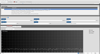

    In both "collector" and "sensor" examples, PHY which we are using, is "50 kbps, 2-GFSK." In the CCS IDE.sysconfig file, I can change PHY to the few listed, but in SmartRF Studio 7, I can check more than listed in the.sysconfig file.
    Using the "Smart RF Studio 7" tool, I need both the launchpads to be in live debugging (using LP-XDS110ET debugger * 2). Is our understanding correct?
    Manivel
  • Hi Manivel,
    for TI15.4 only the Phys shown in sysconfig are supported. In SmartRF Studio all Phys that the device can support are shown. They correspond to different software stacks.
    Please use for the testing the same Phy that you want to use in sysconfig for TI15.4.
    For testing you need to connect both launchpads to an XDS110 and then connect them over usb to a computer. When you open SmartRF Studio it then highlights the device that you connected. You need to select the same phy and then you can test with one board in packet tx and the other board in packet rx.
    Kind regards,
    Theo

    Additionally, where we can find the details about the large network stability test , mentioned in the  Table 6.2.1.
     like
    1. Which PHY that they have configured for testing the 100 nodes (in FCC and ETSI).
    2. What is the maximum distance that they have placed the sensors.
    3. Reporting time 20s means every 20s only the sensor data is transferred - is that our understanding correct?.

    I can already answer:
    1. Going through the lines of the table the configurations are:
    • FCC, 5 kbps Simple Link Long Range, Beacon Mode, 75 Nodes
    • FCC, 5 kbps Simple Link Long Range, Non Beacon Mode, 100 Nodes
    • FCC, 50 kbps 2-GFSK, Frequency Hopping Mode, 75 Nodes
    • FCC, 50 kbps 2-GFSK, Frequency Hopping Mode, 100 Nodes
    • ETSI, 200 kbps 2-GFSK, Non Beacon Mode, 100 Nodes
    2. For the Large Network Test the bards are placed in a rack setup and different network topologies are enforced by the software. This is only the software evaluation test for 15.4 Stack. The board hardware is characterized in various other tests. E.g. the boards antenna characteristics can be found here: https://www.ti.com/lit/an/swra496a/swra496a.pdf pages 178, 183.
    3. This depends on the mode that you are using. In our User's Guide the different modes are explained in detail: https://dev.ti.com/tirex/explore/node?node=A__AITUIbVTzCdD7w7KebQ-qA__com.ti.SIMPLELINK_CC13XX_CC26XX_SDK__BSEc4rl__LATEST

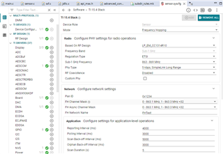

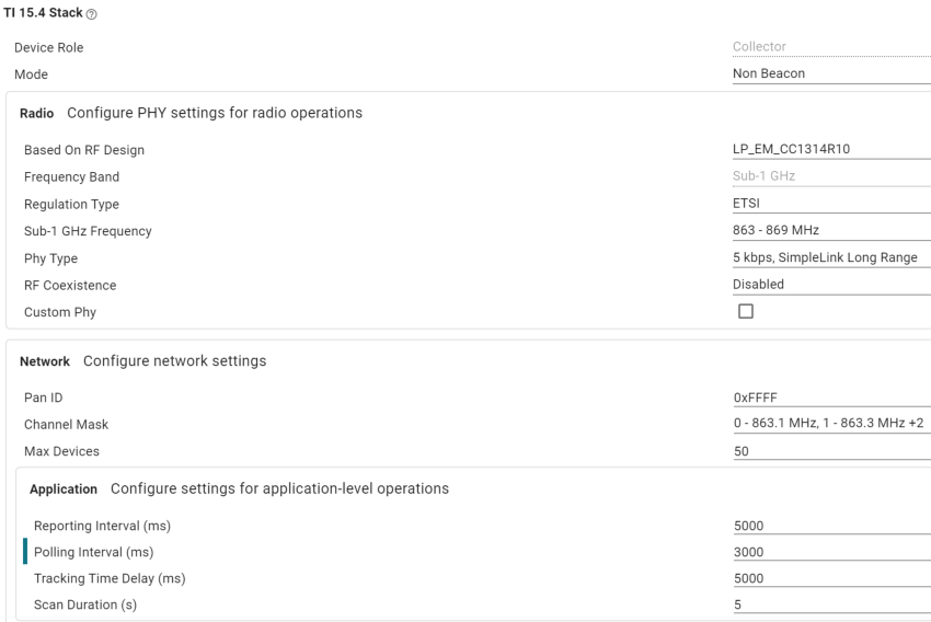

    2. I had attached the .sysconfig image of both collector and sensor examples, followed by,
    collector:
    Sensor:
    3. Now the transmit power we are using is 12 dBm for both the collector and sensor.
    4. Sensor-1 distance 20 m antenna towards collector antenna and Sensor-2 distance 15 m antenna sideways to the collector antenna.

  • Hi Manivel,
    from your sysconfig settings I can spot that you set the Polling Interval to 20000 ms.
    When you click in sysconfig on the question mark right after "Polling Interval (ms)" you will see the following hint: The polling interval must be within the range of the MIN_POLLING_INTERVAL and MAX_POLLING_INTERVAL defined in the sensor project. By default, that range is from 1,000 to 10,000 ms.
    1. I would recommend you to adjust the polling interval to be in the specified range (e.g. 9000 ms). You can leave the reporting interval set to 20000 ms.

  • Hi Theo,
    Thanks for your valuable insights.
    We are using the  range estimation tool for testing the range for respected PHY, antenna, and absorption material.
    At our office indoors, the noise floor value is around -120 dbm (attached the screenshot), yet we need to measure the noise floor value in the testing environment. When changing the noise floor value to -120 dBm in the  range estimation tool., we could see the notable difference in the range. In the testing environments, the noise floor value might be low further, which could affect the range as well.
    So It is quite difficult to achieve the good range with this noise floor level. Regarding your question,
    1. We are unable to get the spectrogram of the current environment.
    2. We sent our device specification to you in private.
    Kindly help us to achieve a better performance. We really appreciate your continuous support and involvement to build a better product using the TI's devices and drivers.
    Muniyappan R.M

    Thanks for you continuous support,
    I am currently implementing different reporting interval for each sensor. Similarly I want to work on the polling interval as well. Because As a part of our requirement, we need  to send the unique data from collector to the one particular sensor whenever needed ( but from the collector to sensor, the data can be sent at each poll time by the sensor.)
     I have implemented the new commands by referring the training labs (Smsgs_cmdIds_genericReq and Smsgs_cmdIds_genericRsp),
     typedef enum
       /* Device type response msg */
       Smsgs_cmdIds_DeviceTypeRsp = 17,
       /* Generic request msg */
       Smsgs_cmdIds_genericReq = 18,
       /* Generic response msg */
       Smsgs_cmdIds_genericRsp = 19
     } Smsgs_cmdIds_t;
    I am assigning the data to one sensor from collector by using the Smsgs_cmdIds_genericReq using the API sendMsg(). It was sent to the respective sensor in the next polling request. In the sensor side I am processing the Smsgs_cmdIds_genericReq cmd and do our implementation.
    We have the following queries,
    1. All the sensors should be configured the same polling interval or we can change the polling interval to each sensor (by collector configuration message)?
    For example if I set the polling interval as 1000ms in the collector side and connect 10 sensors, does all the 10 sensors should have the same reporting interval of 1000ms?.   If yes,
      a. If I assign a message to all the 10 sensors, whether it will be delivered to all the 10 sensors within 1 second (since all the sensors configured as 1000ms of polling time) without fail?
      b. Whether It will affect the performance?.
    2. Do we need to implement the response path as well from the sensor?. i.e using the Smsgs_cmdIds_genericRsp command.
    3. How to handle the retry scenarios, Once the data is assigned to a sensor using the API sendMsg(), whether the stack will make the retires if it is failed to send on one polling request?.
    4. Can I assign Multiple messages to one sensor within one polling request?.
    Muniyappan R.M
  • Hi Muniyappan,
    great that you could implement the custom message sending,
    The polling interval: "Configures the interval in milliseconds for how often a sensor device polls its parent for data."
        - This means that the sensor will wake up according to this interval and send a data request to the collector. This data request is answered by the collector        with a message from the message queue. https://dev.ti.com/tirex/explore/node?node=A__AITUIbVTzCdD7w7KebQ-qA__com.ti.SIMPLELINK_CC13XX_CC26XX_SDK__BSEc4rl__LATEST
        - The polling interval has to be the same for all sensors in the network to ensure that all devices are synced and the collector is ready to receive from each        device once it wakes up.
    The reporting interval: "Configures interval in milliseconds for how often the device will report data."
        - This means that the device wakes up in that interval and sends a data message to the collector. It works because the collector is never sleeping and in rx        when it is not sending any messages.
        - This interval is also set by the collectors configuration message to the sensor but you can ignore this part of the configuration message in code and
          implement different reporting intervals for each sensor if needed.
    The polling interval of the sensor defines how often it will ask for data from the collector. If you send a message on the collector it is stored in a message queue and sent once the next data request from the sensor is received. The lower the sensors polling interval the higher is the responsiveness of the network. If you want to deliver to the 10 sensors the message in 1 s with a 1s polling interval of all the sensors this would only be possible if their next wakeup is scheduled to be right after you send the message to the queue. I would recommend to test this with the exact payload that you want to transmit. You also have the option to send broadcast messages if you want to reach all devices in the network.
    When you followed this lab: https://dev.ti.com/tirex/explore/node?node=A__Ad2.9fPbq0Ip1JEbNHZlww__com.ti.SIMPLELINK_ACADEMY_CC13XX_CC26XX_SDK__AfkT0vQ__LATEST then you have implemented all necessary steps. Important is that both devices know about the new message type. One device fills it and sends it and the other one receives it and sends a response. You have always these two sided that need to be configured as shown in the lab.
    The retries are performed automatically if no acknowledgement was received. There is no additional implementation needed from your side.
    If you send a message to a sensor by calling the api it is always written to a message queue. This queue is emptied once the sensor polls for data. Each poll request is answered with one data message so you need to make sure that the polling interval of the sensor corresponds to the interval that you want to send messages from your application.
    Kind regards,
    Theo

    Unfortunately we don't have that amount of sensor boards. So we tested with the following setup,
    Setup :   Collector device and  two sensor devices. Frequency hopping mode. PHY - 5 kbps, SimpleLink Long Range - ETSI .Tx power 14dbm. I am having al these setup with in the 10meters.
    Sensor configuration:
    Collector configuration:

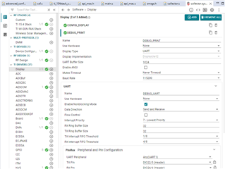

    1. When you use debug prints are you using a second UART or did you extend the serial cli interface as shown in the SimpleLink Academy about custom messages?
    >> I have initialized the separate UART .

    Sending the command - Smsgs_cmdIds_genericReq   to Sensor Addr 1, when pressing the Button 1 and if it is successfully queued, incrementing the sensor_addr1_poll_tx count . Similarly Button 2 for Sensor Address 2.
    Implementation - Sensor side:
    Whenever Smsgs_cmdIds_genericReq command is received, I am toggling the Green Led and incrementing the poll_rx_count .

    As we told earlier we reverted back to the Non-beacon mode and conducted the testing. Following are the results,
    Setup:
    1 collector board and 1 Sensor board (unfortunately we could not able to use 2 boards)
    PHY : 5 kbps, SimpleLink Long Range.(ETSI)
    Intervals:

    We have enabled the Frequency Hopping settings on the Sysconfig and keeping the other settings same (the intervals, PHY). and did the testing,
    Enabled only 2 channels for frequency hopping in both the sensor and collector side in both collector and sensor (Only for Initial testing)
    From Sensor to collector, sending data every 1 second (reporting interval).
    From Collector to sensor, sending data every 4 seconds
    Additionally in Frequency hopping , the broadcast time is set as10seconds by default.
