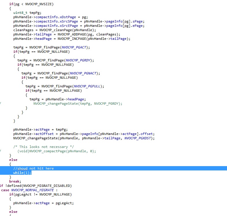

Sometimes, the device cannot work anymore when power on(the power consumption keep at 4mA). I enter the debug and find the program enter while() loop(nvocmp.c --> NVOCMP_initNv() --> NVOCMP_RECOVER_ERASE see below). We don't know why the program enter this area. Do you have any suggestion for this problem? Is there any side effect if we "break the while "directly? Thank you

  • Hi Kimi,
    NVOCMP_RECOVER_ERASE could occur due to power poss after NV page compaction is finished but before erasing the PGXSRC page, or another unexpected page state value is determined:
    #if (NVOCMP_NVPAGES != NVOCMP_NVONEP)
        else if(noPgXsrc)
          // Power lost during compaction in progress
          if(noPgXdst)
            action = NVOCMP_RECOVER_COMPACT;
          // Power lost after compaction done, but before erasing PGXSRC page
          else
            action = NVOCMP_RECOVER_ERASE;
        else if(noPgXdst)
          action = NVOCMP_NORMAL_RESUME;
        else if(noPgAct || noPgFull)
    Can you determine which of these cases apply?
    Ryan
  • Hi Ryan,
    It hit first "action = NVOCMP_RECOVER_ERASE;"

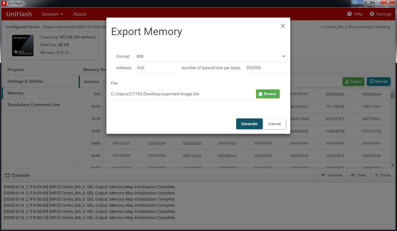

  • Since you can reproduce this on your LaunchPad, can you help to provide a NV flash memory capture when the problem occurs as requested by ?
  • This basically entails reading out the memory of the NV flash area after the issue occurs, however since the modified nvocmp file appears to address the issue then no further investigation may be required.

    From your description it would appear that the device no longer gets caught in a while loop yet still has NV corruption on a restart.  Is any radio activity possible at this time?  Would you be able to provide the flash memory contents during this state?  You can debug a running target by selecting Debug Configuration -> Program -> Load symbols only inside of CCS.

    8015.20200316_noRF.zip
  • Thanks for providing the device's memory contents, I will have our NV driver expert check for inconsistencies.  I assume the default FLASH_NV_BASE of 0x52000 and FLASH_NV_SIZE of 0x4000 is used?  Does the device not have any radio activity and may it be related to your other E2E post?  https://e2e.ti.com/support/wireless-connectivity/zigbee-and-thread/f/158/t/888891

    I do not see any issues with the flash memory contents that you provided.  This is exported during its broken state, correct?  Please also provide a memory export of the device in its working state so that we can compare them.

    I provide 3 files to you (new program, join network and work correctly, no RF activity)
    20200318_CC1352P NV.zip
