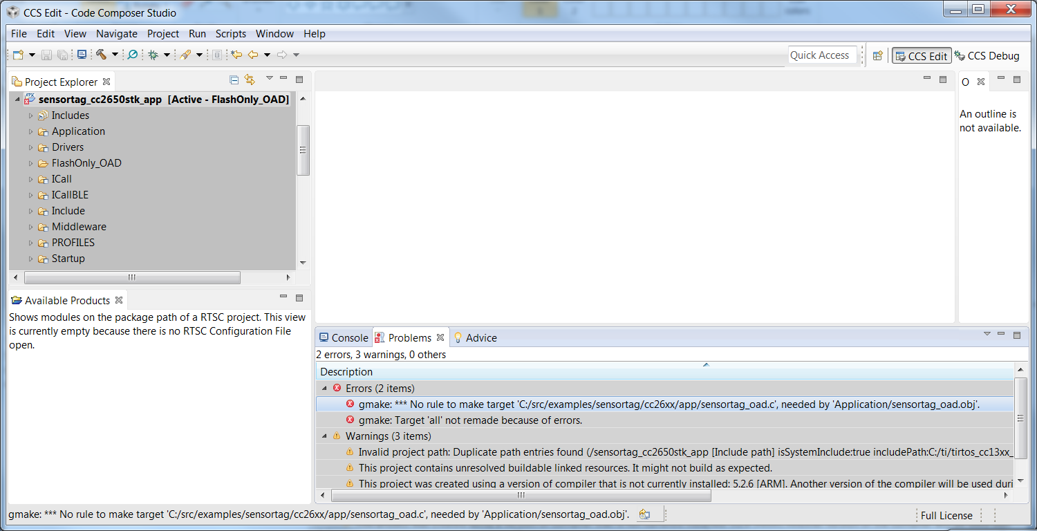

After importing the sensortag_cc2650_stk_app project as is with "Copy projects into workspace" option checked, and try to compile it, you might see the following error:
Description Resource Path Location Type
gmake: *** No rule to make target 'C:/src/examples/sensortag/cc26xx/app/sensortag_oad.c', needed by 'Application/sensortag_oad.obj'. sensortag_cc2650stk_app Unknown C/C++ Problem
in order to fix this problem, search for "sensortag_oad.c" and "sensortag_oad.h" in the project explorer under "Application folder". If you click both files you will see the warning that it is not properly linked to the CCS project.

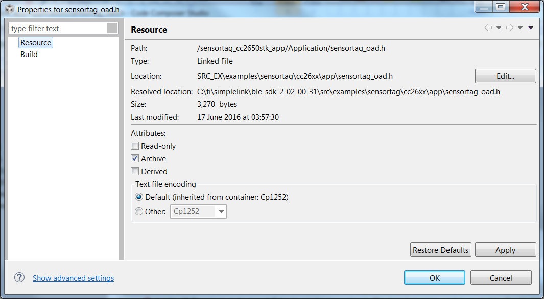

To solve this, do right on each file, and select "Properties", then you will get a pop-up window like this:
click the "Edit" button, and change the location from:
PROJECT_LOC\..\..\..\..\..\src\examples\sensortag\cc26xx\app\sensortag_oad.*
to:
SRC_EX\examples\sensortag\cc26xx\app\sensortag_oad.*

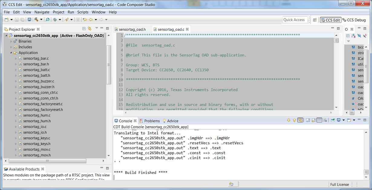

You should be able to click both files without warning now. Then Voilà! the project can be compiled now without errors.

I clicked on the link and found it took me to the same page where I had got the 'CCS App Center' update/upgrade procedure, which did not work. However I re-read your reply and realized you were wanting me to use the procedure just above that section, titled 'Install new features'. I followed your directions (very good - thanks) and was able to get ARM Compiler Tools version 5.2.7 installed successfully. Now when I build the sensortag_cc2650stk_ projects I do not get any build errors.
Many thanks - problem solved.
