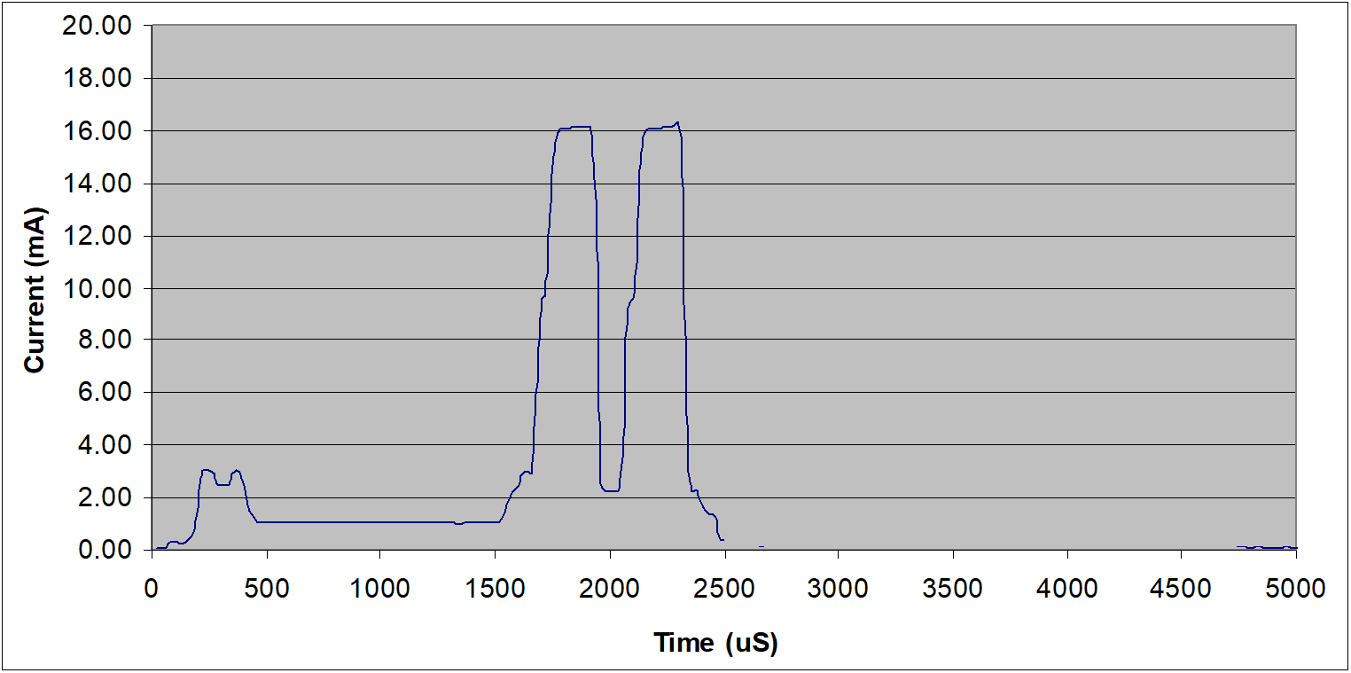

We are using the CC1310 Launchpad to measure average power consumption of a basic polling receiver using the sniff mode example code. We are measuring almost the exact same curve shown here (https://e2e.ti.com/support/wireless_connectivity/proprietary_sub_1_ghz_simpliciti/f/156/p/547760/2005088
While the actual RX active time looks pretty good, there is a lot of time before this that is taking about 4mA. I'm guessing much of this time is oscillator settling time, and this adds up to a large part of our power budget. The average power for checking the radio receiver, assuming a wake-up once per second, is about 10.5uA.
Is there any way to reduce this current consumption or time? We've experimented with the RX bandwidth and datarates, but these only slightly shorten the RX active time, and have no affect on the timing / current draw before the RX becomes active.
This is actually worse than our older CC430, which only took about 1mA during this time. The average power for checking the radio receiver, assuming a wake-up once per second, was only about 7.2uA, and this was for checking 2 channels! Here's a plot from our older CC430 performing the same radio check for two channels instead of just one:

    When going from standby to RX in the WOR example, the Rf core must be powered on, the crystal must stabilize and the radio setup command and the CMD_FS must run. In addition all patched for the particular PHY you are using must be loaded.
    Unfortunately that takes typically around 1.6 ms and there is not much that can be done with respect to make this time faster/current lower.

    I don't think so. Before going into RX, the CC1310 enables the external HF crystal, powers the RF core up, loads firmware patches and switches to the external oscillator. This happens in parallel, but the chip wakeup takes 300 µs, the RF core power-up procedure takes about 1 ms where the CPU is in active state, that's why you see such a high current consumption. On the CC430, everything radio-related was solved in hardware.

    However, it does seem a bit disappointing that the new CC1310 takes 66% more current as a polling receiver than the older CC430. The CC430 had an option to disable the frequency synthesizer calibration, which significantly improved the RF core power-up time. We would manually calibrate on power-up, store and load the calibration values with each RF sniff cycle, and then re-calibrate periodically or after temperature changes.
    Is the CC1310 doing something similar, or capable of doing something similar? Would this reduce the RF core power-up time?

    It is not possible to turn off calibration the way we do it on our older devices, so there is not much to do with the timing unfortunately.
    You can take a look at the Sniff mode feature for our transceivers (CC1120 and CC1200). There is an Excel sheet in the app note (http://www.ti.com/litswra428) that will calculate the current consumption for you for different settings/preamble lengths.
