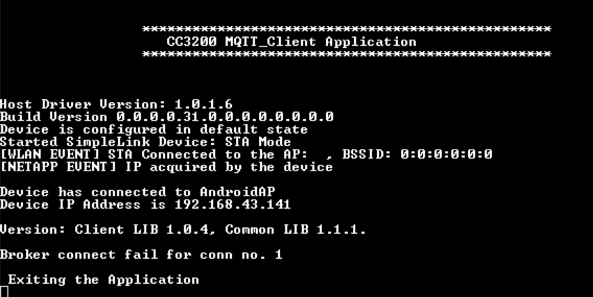

I'm trying to make the MQTT_client demo work on my CC3200 Launchpad but I'm having trouble to connect the IBM broker.
The sl_Connect function in the socket.c sheet returns the error -111 which indicates a refused connection.
Is there anything to configure on the IBM server ? Because when I connect my PC to my phone I can ping several websites but I can’t ping “messagesight.demos.ibm.com”.

    You will not be able to ping or connect to messagesight.demos.ibm.com via browser as it is only a part of the complete URI.
    In any case, have you flashed the latest 1.0.1.6-2.7.0.0 servicepack?
    From the printouts it seems you have all 0 for build version.
    I am not saying that this is the issue but first please update it via Uniflash and retry.

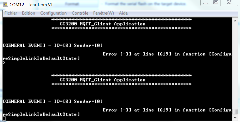

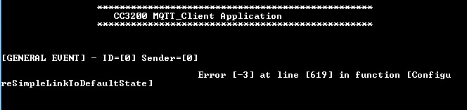

    When I flash the 1.0.1.6-2.7.0.0 servicepack (I tried to format with 1MB Capacity and with 512KB), I get an Error at the beginning of the demo. It appears after the call of the sl_Start(0, 0, 0) function line 618 of the network_if.c. I tried to reset manually the board but I got the same error.
    If I only format the cc3200 launchpad, I get a similar error at the first connection but then after reseting manually the launchpad I can get further in the demo.

  • Strange,
    Without serviecpack installed, it runs from ROM and it is highly not recommended.
    What device version are you using? you can tell from the silk label on the CC3200 chip.
    Shlomi
  • The chip is XCC3200HZ
    437
    ZCEV G3
    Model : CC3200-LAUNCHXLA
    Bastien
  • OK, this explains everything.
    You have a pre-production chip that would not work with the servicepack nor the latest SDK.
    You must move to production device in order to proceed.

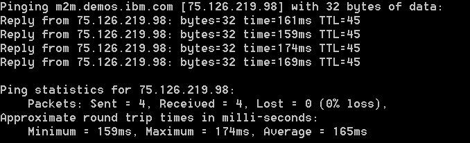

    I tried with two differents AP (shared connection of mobile phones) with the same results. I can ping "m2m.demos.ibm.com" but I can't connect to it with any browser, I get the "unable to find the proxy server" error.

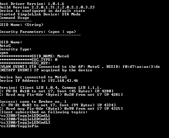

    However, during debugging if I am giving single breakpoint at the void MqttClient(void *pvParameters) function (line 747 of main.c) and then going step by step pressing F6, i am getting prompt for SSID, Security key etc. I gave SSID of my open wifi network and it connected. Further went down by pressing F6 and some more thing showed up on terminal as follows.
    As it can be seen, it is giving successful connection to broaker 1. However after some steps it gets stuck at GPIO_IF_LedConfigure(LED1|LED2|LED3); which is at line 946 of main.c. Also i am unable to connect to the web client from computer. In the code the client id is "user1". Can you kindly suggest possible solutions? Also, giving one breakpoint at MqttClient function doesnt seem to work everytime (not alwsys it prompts for SSID).
