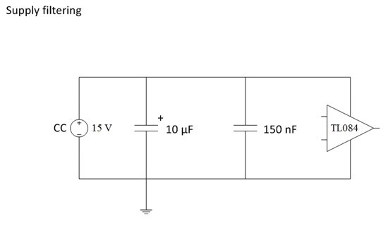

I've made a TL084 voltage buffer to use with a TDA7297 power amplifier, but the buffer is oscillating at low frequencies at the startup, can someone sugest me other opamp or some measure to solve this problem, the circuit scheme is attached.

Hi, Daniel,
Clearly you should not be trying to drive an ST part with a TI op amp! You should clearly be using something like the LM4766!
Seriously, I am not sure I understand the issue. Can you post a scope shot of the oscillation you're seeing?

Hello everyone
The problem is solved, the IC was with problems in ground connection, know it works perfectly.
