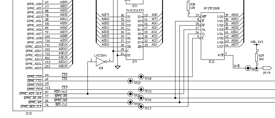

We are developing a custom AM335x board (based on the BeagleBone and AM335x Start Kit) with a Micron MT29F2G08ABAEAWP 2Gbit NAND chip.
This is an 8 bit device, connected to CS0, as follows:-
I have compiled the latest git U-Boot 2013.01, and (with a custom config, board.c and mux.c file - attached below) I am able to boot from MMC (SYSBOOT[4:0] = 10111) :-

But when I switch our board to NAND booting (SYSBOOT[4:0] = 10011), I get nothing on UART0.
Using a scope, I can see that the NAND signals are being toggled (in a burst of activity every 10ms).
The Micron NAND device does have it's own internal ECC hardware, but I think it is OFF by default.
I have tried SYSBOOT[9] at both a '0' and a '1' (to turn ECC mode on / off) but neither mode works.
Can anyone assist me in tracking down what might be wrong ?

  • Mark, have you connected GPMC_WAIT0 to the R/B signal of the NAND?  This is not evident in the snapshot you sent.  This is used by the ROM to properly throttle commands/data to the memory.
    James

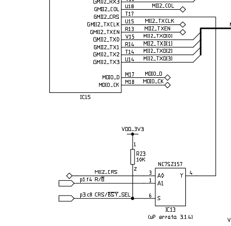

  • Yes ... as per errata 3.1.4, it goes through an analog switch to ball T17 (as we're also using Ethernet port 1):-
    Hopefully that's designed right ??
  • Mark, that looks correct.  Can you probe the WAIT signal to see if you are getting the proper level during boot?
    james
  • James
    It sits high most of the time, but then goes low for a period after most (but not all) write cycles.
    Mark J.
  • OK, that seems to be working.  If you are getting nothing on the UART, then it looks like the NAND is being recognized but something went wrong in the initial read of MLO.
     Do you have JTAG access?  If so, after a crash, what is the PC value?
    James

    One other thing I'm not sure about ...
    Since we're using an 8bit NAND device, we've configured SYSBOOT[8] as a '0'.
    But in the TRM (section 26.1.7.4.2.2 Pins Used) there's a warning about AD[15:8] being used (as outputs ?)
    I assume that, since we've configured SYSBOOT to indicate an 8bit NAND, the upper half of the data bus is not used by the boot ROM code when reading / writing to the NAND device ?

  • Hi Mark,
    SYSBOOT[8] is irrelevant when trying to boot from NAND.  The ROM will configure the width based on the ONFI parameters it reads from the memory.
    The JTAG emulator you mention will work. Part of the reason to get this working is to see how far into the NAND boot the code got.  Is the PC still stuck in the ROM?  Did you get an abort?  Is there valid code in the internal SRAM?  This will go a long way to determine what's wrong.

  • James
    Just a quick update ... I've added some 10K pullup resistors to the upper data bus (AD[15:8]) even though we're booting from an 8bit device.
    I guess the AM335x internal boot code assumes everything is 16bit.
    It might be worth noting in the TRM that SYSBOOT[8] is not used to configure 8/16bit device !!
    Mark J.
  • James
    Just to update my update (!!) ...
    I actually needed to use pulldowns (not pullups) to get it to boot reliably.
    So I guess the TI boot ROM code is not masking the top 8 bits when the chip starts up, and is just expecting the top 8bits to be all zeros.
    Mark J.

  • Mark, can I clarify something with you...
    Do i read correctly, that when the high 8-bits of the GPMC bus (GPMC_AD8 - GPMC_AD15) are pulled up, the processor does NOT boot from 8-bit NAND. And when those same bits are pulled down, the processor DOES boot? Were there any other hardware changes between the boot vs non-boot configurations?
    Our board boots from an 8-bit NAND. We just have "random stuff" on the upper 8 bits of the GPMC bus (some LEDs etc).  It would be a bit distressing if we found boards started becoming intermittent in their booting.
  • Frank
    Yes ... we are using a 16bit address / data bus (AD[15:0]) for a NOR flash and FRAM device.  But our NAND chip is only connected via the bottom 8 data bits (AD[7:0]).
    I have found that I was unable to boot from NAND with the upper 8 bits (AD[15:8]) left "floating".
    If I pulled AD[15:8] *up*, then it *sometimes* booted, and I also noticed that by placing a scope probe on any of the upper data lines (or sticking my finger on various parts of the pcb), it seemed to get much better.  I guess the extra capacitance of the scope probe was affecting the rise-time of the pullup resistor.
    So I then changed the pullups to pulldowns, and this has cured it completely.
    James from TI has informed me that the upper data bus is unused by the boot rom code, and he tested this with a BeagleBone with an 8bit NAND chip added (possibly on a cape board?).  He then pulled one of the upper data lines high, and confirmed that it made no difference.
    No whether there's a bus loading issue with our design (as we have multiple memory chips hung off the GPMC bus), I don't know, but I've now performed 100+ reboots (with pulldowns) over the last couple of days, and I've not had any problems.
    Do you have any other 8 or 16 bit memory devices, or is your NAND device the only memory device hung off the GPMC bus ?
    Mark J.
  • The 8-bit NAND is the only memory device on the GPMC. There's nothing else on the GPMC except for the misc things like LEDs.
    One thing we did learn is that the upper 8 bits of the GPMC are _driven_ by the ROM bootloader during NAND boot. That initially caused us some grief, as we had a signal on an early proto board hooked up to one of the upper GPMC data lines, and it wasn't happy about that. We ended up moving it to a different processor pin to get around that particular problem. We haven't seen any issues booting from 8-bit NAND since then.

  • Hi guys, just to clarify a few things:
    Yes, the ROM does initially configure the GPMC into 16-bit mode, and configures all D0-D15 pinmux signals, so it will drive all 16 data signals initially as it is trying to read IDs and ONFI data.  The 8/16bit SYSBOOT[8] configuration is not used for NAND boot, only for NOR boot.  The boot ROM will determine the width from the initial parameters it reads out of the NAND, and then configure accordingly.
    I tried to reproduce Mark's issue with beaglebone and NAND cape, but from what i can see, the ROM only uses the lower 8-bits that it reads (the IDs and ONFI data is read a byte at a time), so even after forcing an upper bit to hi, it had no effect on the boot.
    Mark, another idea i had for your board.  Is it possible that the other things hanging off the GPMC bus (you mentioned a NOR and FRAM) are driving during boot, possibly corrupting the data that the ROM is trying to read from the NAND?  Can you check the chip selects or other enable signals for these memories during the NAND boot?  I'm not sure how that is related to your fix, but this could possibly be a cause for your NAND boot failures.
    James
    James
    I've checked all the other nCS signals when the board is booting and none of them are being asserted.
    All the other signals are (obviously) active.
    The only strange behaviour is on the upper data bus.  When the NAND chip select and nRD are active, the unused lines gradually float up to about 800mV.
    Might this be some contention between the internal GPMC pullup and our external pulldown ?
  • Mark,
    yes, this is probably the 2 pulls fighting each other.  The internal pull is typically around 33K, so assuming you have a 10K pulldown, this would create a voltage divider with the voltage you are seeing.
    But based on what i am seeing in how the ROM behaves (ie, it only uses the lower 8 bits), this shouldn't matter.
