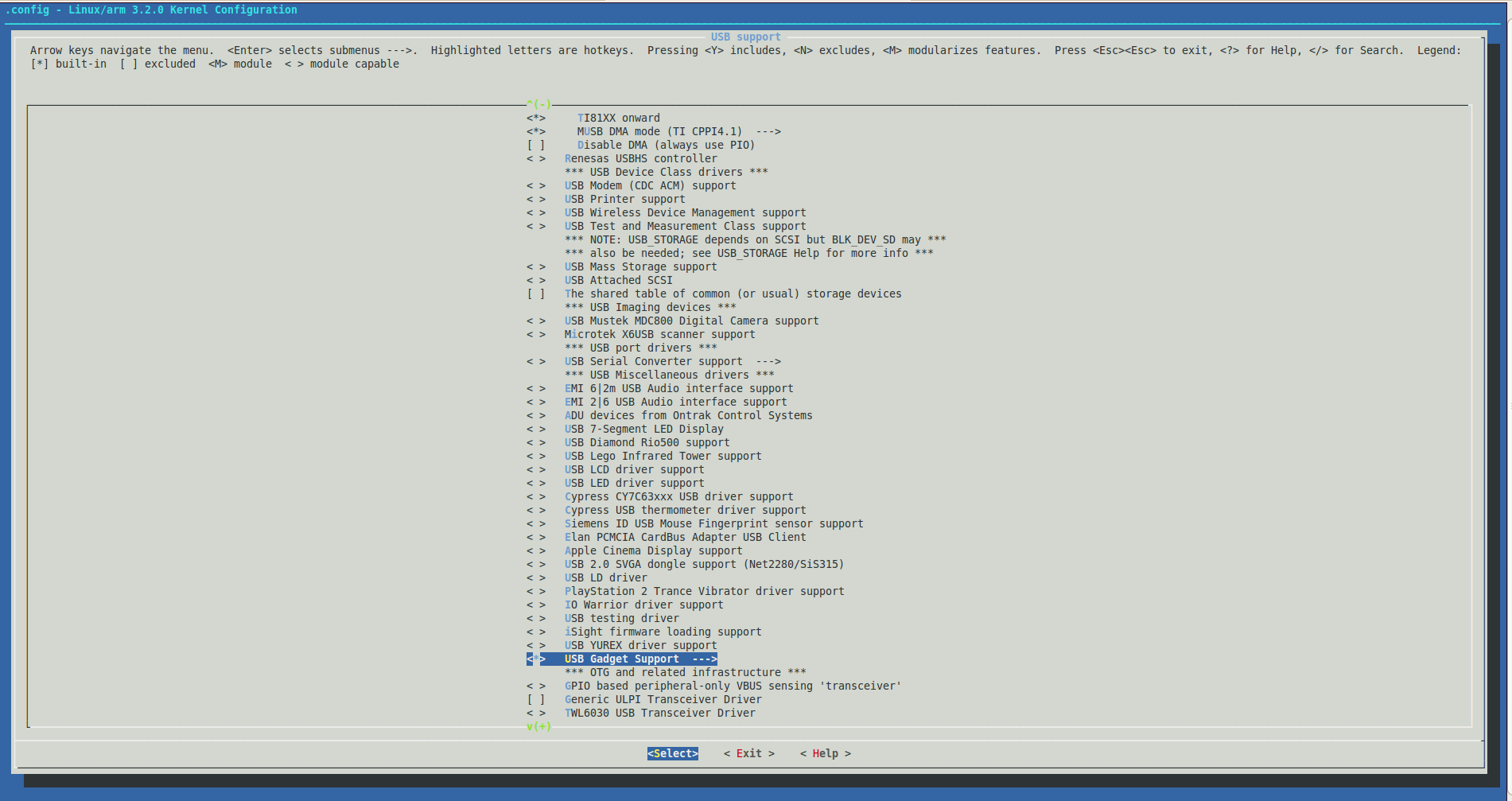

Hi!
I have custom board based on AM335x almost copy of AM335x-EVM-SK the only one big difference on this board absent Ethernet; instead USB is used. USB part is pin-to-pin similar to AM335x-EVM-SDK (UART0, JTAG, USB0 are connected to FT IC and to HUB IC and all these to micro-USB header).
U-Boot is ported and launch fine, HOST is configured and has /tftpboot and /targetNFS folders for upload linux kernel and mount NFS rootfs respectively. From U-Boot I can download kernel from tftp and from NFS folder (the last is just to confirm HOST NFS is work properly). Board has staic IP=10.10.0.2 and HOST IP=10.10.0.1 here is bootargs U-Boot successfully passes to kernel:
console=ttyO0,115200n8 root=/dev/nfs rw ip=10.10.0.2 nfsroot=10.10.0.1:/home/dev/ti-sdk-am335x-evm-06.00.00.00/targetNFS,nolock rw rootfstype=nfs
I've started to port Linux Kernel from 06.00.00.00 SDK from git branch "06.00.00.00-template", all compiled fine and loaded by U-boot from TFTP here is log of booting process since power on time:

  • Vasiliy,
    The standard defconfig has the usb mass storage gadget  built in. You need to change that config to remove the mass storage, and include the ethernet gadget, g_ether. Especially if you want to mount over NFS.
    Hope this helps...
  • Hi Ron,
    Thanks for reply.
    So,
    Steps done in Ubuntu command line:
    ubuntu$ make mrpropper
    ubuntu$ make ARCH=arm am335x_evm_defconfig
    ubuntu$ make ARCH=arm menuconfig
    Steps in kernel config menu:
    (set) Device Drivers  ---> USB support  ---> USB Gadget Support  ---> [*] RNDIS support
    (unset) Device Drivers  ---> USB support  ---> USB Gadget Support  ---> [ ] Mass Storage Gadget
    (unset) Device Drivers  ---> USB support  ---> [ ]USB Mass Storage support
    Is it enough or there is some extra steps? And thanks for help!
    Vasiliy

  • You have to build g_ether module into uImage, not as module. Until the rootfs got mounted g_ether.ko cannot be loaded, so NFS failed.
  • Hi Bin
    If I'm correct "M" in menuconfig means module "*" - static. Here is my menuconfig view:
    and here is .config
    So, seems it is statically compiled, or not?
  • WOW! Bin You were right inside "*" there were marked "M", now after re-compile NFS rootfs work!
    Thanks to all helpers!
