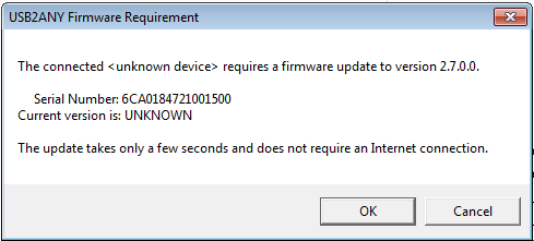

I recently got a LMX2571 EVM which came with a USB2ANY module. I installed Codeloader 4 as mentioned in the user manual http://www.ti.com/lit/ug/snau176a/snau176a.pdf
When I connect the USB2ANY with codeloader 4 running, I get an error that a USB2ANY firmware update is required
Windows finds a HID driver for USB2ANY in default mode but does not identify it in BSL mode. Attempting to update the driver of the unknown device by pointing to the Program Files(x86)/Texas Instruments/Codeloader 4/ directory (with subdirectory search on) does not install any of the packaged drivers (if any)

  • Adwait,
    You are already at the right place. When there is a new Firmware released, you will get this pop up. Just press OK and you should go through the instructions on how to upgrade. see attached slides that goes through that too.USB2ANY firmware_OLD.pptx
  • After a lot of tweaking around, I finally managed to get CodeLoader's firmware updater to work.
    The solution was NOT to install Codeloader in the default location in Program Files (Change it so something else like C:\Codeloader).
     Installed elsewhere, the update application works fine.
    I would still love to have a *NIX command line tool for this though.
  • Adwait,
    Thank you for your feedback regarding CodeLoader.  I am not a big fan of installing things to the program files directory because when you do, windows actually uses another directory called the "Virtual Store".   This has caused confusion and issues with CodeLoader and we do mention that you might not want to install it to the program files directory in the CodeLoader instructions.
