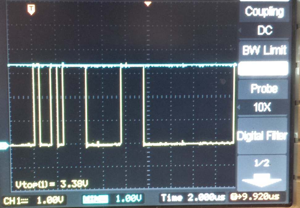

  • Dear Chris,
    I think I made some progress since this post to now.  It turns out I was reading SPI data on the rising edge of the clock, and I should be reading it on the falling edge.  I experimented since it is not called out in the datasheet, or at least I could not find it.
    There is a bit of a small problem still, and I think this is with the PIC Micro though on the SPI side.  When i call my initialization routine after power up to send SDATAC command, and update my Delay and Sampling rate in the appropriate registers, I have to call the routine twice.  It is as if the SPI is double buffered and first time the data does not read, but there after it is fine.  I will investigate this further.
    I thought I should update you the issue was with the phase of the clock when sampling on the Rising edge.  It needs to be on the falling edge.

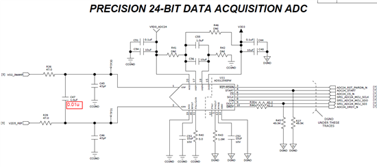

  • Dear Chris,
    I investigated further, and I am now convinced it is not the Microcontroller or the SPI firmware routines.  I soldered a wire right at the DOUT pin, and I can confirm data is certainly going out to the ADC, but when I query it, no data returns.  If I do this several times in a loop, the ADC finally catches ON (8 times).
    Attached is my schematic and the scope capture, confirming no data comes out, unless I hit it several times, no less than 8 times.
    It feels like there is a time constant or something not quite catching on.  I had 11uF on the reference pin, and reduced it to 1uF.  I wait for more than 1sec.
    1. SPI clocks I have tried 1,4,5,6.67,10 MHz.  I am not sure if this matters.
    2. 10MHz SPI clock speed seems to read.  On the data sheet is say 1.8, but I am not sure what that is.  1.8  x 7.3728MHz?  I am not sure what that nomenclature means.
    what could be the problem?  What is preventing the ADC to pay attention to me in the first call?
    Blue trace is DOUT right at the Chip, yellow trace is the clock pulses to trigger.
  • Hi Roberto,
    Thank you for the screenshots and schematic images -  they are very helpful! I've been looking over your posts from the weekend and will try to answer most of your questions here...
    Grounding
    The one thing I noticed that could be the crux of most of your issues is the analog and digital ground connections. You have separated them on your schematic and did not show where you reference these ground potentials to each other. For layout purposes if you want to keep these grounds mostly separate it is okay, but you need to connect AVSS and DGND at the ADS1259.
    (If you intend to use isolation in your system, then you would isolate the digital signals going back to your microcontroller. The separate AVSS and DGND grounds on the ADS1259 are there to keep the digital noise out of the sensitive analog circuitry inside the ADS1259; however, they still need to be connected together at some point - preferably right at the ADS1259.)
    SPI Communication
    Once you make sure analog and digital grounds are biased to the same potential, then SPI communication should start to work. The ADS1259 does indeed use the falling edge of SCLK to read DIN data. More specifically, it uses SPI mode 1 (a good article on SPI modes can be found here: http://www.totalphase.com/support/articles/200349236).
    Next the SCLK frequency is important - its frequency is limited by the ADC clock frequency. SCLK has a minimum period of "1.8 * tclk" (another way to say this is that the maximum SCLK frequency is fclk/1.8). Therefore, since you are using the internal 7.3728 MHz clock, your SCLK is limited to 7.3728 MHz / 1.8 = 4.096 MHz (max). Using 10 MHz for SCLK will not work, even though you still see activity on the DOUT signal.
    You SPI sequence would be the last thing to check. From your logic analyzer screenshot, your SPI command sequence looks correct!
    Please let me know if these suggestions correct the issue!

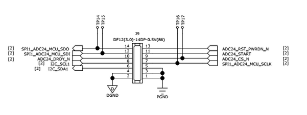

  • Dear Chris,
    Thank you for replying to my posts. The digital, and Analog grounds are separated in this design for the very reason you mentioned.  The analog signals are sensitive, and I don't want to introduce digital noise into them.  Thus I have separate planes returning the current back to the source.
    The system is composed of two boards connected via mezzanine connectors.  The digital and power supplies board sits below, and the analog board connects on top (both boards are about 2.5" long).  There are really two grounds running around, power ground (PGND) in the digital/pwr board  which mates to Analog ground (CCGND) on the analog board, and digital ground all connecting at a single point at the power input jack.  There is an ESD return path, but it is not part of the ADC.  In my mind the grounds are at the same potential, and I will validate this with my DMM  by measuring the voltage observed at the grounds, by measuring the resistance from PGND to CCGND and DGND TO DGND.
    The goal is to return the Digital currents back through the DGND path,  while the analog path returns the currents via analog/pwr gnd combination.  I don't think there should be an issue (at least to me), unless the issue is in the mezzanine connectors DC contact resistance.  These are tiny connectors (x2), and I have at least 2 to 3 pins dedicated for returns, which should be sufficient to lower the contact resistances.
    The images below show the ground connection/returns, and the mezzanine connections.  I believe the grounds are correct in terms of logical connections.
    Do you think on the analog board I should just have a single ground for the entire board including the ADC?  I could do that, but I am worried about failing FCC Class B if the digital signals lose its return path ground reference.  I don't want to connect the Digital ground to the analog board to avoid noise all together.
    As for the clock, I am certainly driving it too hard.  I didn't understand the datasheet 1.8 scale factor.  I can certainly drive it between 1-4MHz to avoid issues.  Is 2.8V digital logic level healthy for the digital signals coming out of the ADC?  I am seeing 2.8V, and I expected 3.3V since VDDIO is 3.3V.
    I could try shorting the two grounds at the ADC but this will create a current loop which may be a killer for FCC.
    I have one more opportunity to layout this analog board.  What would be your recommendations?
    I have
    PGND in the Digital/Power board  joining AGND on the analog board
    DGND on the digital board joining the ADC DGNG return.
    Should I have a single ground plane on the Analog board returning to which ground?  I think PGND is less noisy than DGND due to MCU and other digital parts.
    Please advise
    Robert
    DIGITAL BOARD CONNECTION SIDE
    ANALOG BOARD CONNECTION SIDE
    CCGND = PGND RETURN
    DGND = DGND RETURN
  • Hi Roberto,
    I'd highly recommend this book for you. It is very conceptual and will help you pass FCC emissions tests.
    It discusses different grounding schemes.  You are using single-point grounding, and according to Henry Ott (pg. 126), single-point grounding is only useful for signals below about 100kHz. Above this frequency the ground impedance is very inductive and no longer behaves like a single-point ground. It will be very hard to pass EMI testing using this scheme.
    If you look online for PCB grounding, you'll find many other resources. Most will recommend using split ground planes because that is how it has always been done.
    There are right and wrong ways to use split ground planes. In my opinion, if you have a good split ground plane layout you will not need the split at all; however, if your split ground plane layout is bad, the split may help.
    There is one such discussion on our wiki page here: http://e2e.ti.com/support/data_converters/precision_data_converters/w/design_notes/1393.aspx
    I typically lay out a PCB with the analog and digital circuitry "partitioned" and sharing a single ground plane (The ADC is placed right at the partition boundary).   This scheme keeps the analog and digital ground return currents separated AND it keeps the ground impedance/inductance low. I have been successful so far at doing layouts for our high resolution and low noise ADCs using this method.
    It is essentially like laying out a split ground plane, and then removing the split right before you finish the layout. The analog and digital return currents remain separated because they will follow the path of least inductance.
    Chris
  • Chris,
    Thank you for the suggestions.  It sounds like what you are suggesting is a single ground plane in the end, which I have also done in the past.  For signal integrity purposes, the currents should always return back to the source that produced it.  I was just trying to keep digital to digital and analog to analog.  What I will do then, is create a single ground  for both boards called GND and then by virtue of having a separate board (Analog board), that board will look like an island of copper upstairs connecting the main island through the connectors.
    I think that makes sense to me only if there is a single net called GND.
    Do you concur?

  • HI Roberto,
    Yes! I would just add that you want this path to be as short as possible and with the smallest loop area possible.
    Ideally, all your signals would flow on the top side of your PCB, and then would have a large (uninterrupted) ground plane that would allow the returns current to flow directly below the traces them came in on.
    ...even though you may be doing this with your current PCB, you also need to keep the ADC's analog and digital grounds at the same potential. I recommend just trying an experiment.... Short these grounds at the ADC and see if it fixes your communication (ignoring the fact that you are creating a ground loop). This would also be good to allow you to test your existing board to make sure there aren't any other issues you want to correct before your next layout!
    You could definitely make that work! Just be careful that you don't create too big of a common ground impedance where both analog and digital return currents can couple.
    Multiple boards are not ideal because at some point you have to connect your wide ground plane to a narrow inductive pin. If you have multiple ground pins available (one for analog and one for digital), a good layout might use these pins to keep the analog and digital return currents separated while sharing a single-ground plane.
    I'm not sure how your grounding looks on your power/digital board, but you must also consider that as you layout the analog board.
    If the grounds are split on your power/digital board, you might consider finding places where you could add "stitching" capacitors (on the power/digital board). Stitching capacitors connect between the split ground planes to reduce their impedance at higher frequencies. The good thing about stitching capacitors is that you can always remove them if you find them to be a problem.
    Chris

  • Dear Chris,
    I measured the Dout of the chip reference to DGND, and it is clean now.  I guess I either didn't have a solid connection or too long wires.  I have a little cleaning up to do.
    Here is scope shot.  The signal is not ringing indicating there may be a reasonable termination from driver to load. This makes me feel better.
    I also reduced the clock speed to 2MHz, and things look ok generally speaking.  I will now short the grounds at the ADC and see if this gives me an indication things will be happier if a single ground is laid out.

  • Hi Roberto,
    We've been talking about the SPI communication being suspect due to grounding issues, so how can you conclude that the ADC data is garbage?
    I asked you to probe DOUT near the ADS1259 so that you can observe that where you probe make a difference. If you were to instead probe DOUT where it connects to your microcontroller, I bet it would tell a different story...
    In general, probing right at the digital output SHOULD look clean (You're looking a a driven/low output impedance signal). When you move your probe down the signal trace, to the device pin configured as a digital input, you are now probing a higher impedance and you are likely to see more overshoot, ringing, and phase shift.
    Try probing all of the SPI signals near the ADS1259 and try probing all of the SPI signals near your microcontroller. You're likely to find that both devices are working correctly with the information they are given - but the information is being lost in transmission.

  • Chris,
    Would having a 10uF at the Bypass pin be a problem?  Page 21 says: " A 1uF capacitor must be connected from the LDO output to DGND."  I added 10uF in order bypass better.
    Also on the VREFP/VREFN I have also 10uF||1uF X5R capacitors.  I would think the larger capacitance affects the start-up time, and the dielectric in the cap will have an effect on the stability of the reference.  I believe X5R is stable enough.
    RR

  • Hi Robert,
    I want to make sure I reply to your earlier questions...
    It's not a problem to put a 10uF capacitor on the BYPASS pin.
    (Unfortunately, the datasheet  is not completely consistent on this matter...pg 12 says "...1uF or larger...").
    I discussed this with a characterization engineer and found out that there is not really a difference in performance between 1uF and 10uF.
    You're correct about start-up time dependence on the VREF capacitance!
    See figure 29 in the data sheet for a graph...with a 1uF cap it took about 0.5 seconds to settle within 0.002% of the final value. It would be better to wait 1-2 seconds for the reference to settle. Using a 10uF cap (10x) would have a similar (10x) effect on the reference settling time.
    C0G is the most stable dielectric (X7R is the next best.) Try to use C0G if you can! If you cannot, try to use an X7R with a larger breakdown voltage. These dielectrics are not as "high-k"; and therefore, they require a larger package to achieve the same capacitance - these dielectrics are not available in the larger capacitor sizes due to this reason.
