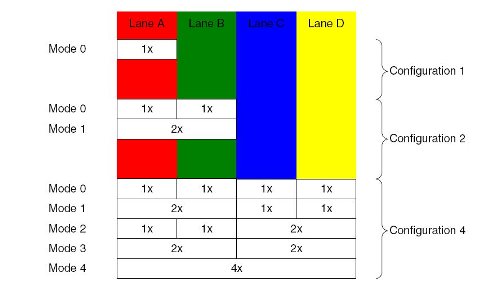

    Path mode = 0, sets up the peripheral for 4 ports, each 1X wide.  Path mode = 4, sets the peripheral for 1 port 4X wide. See the below figure (C66x devices support Configuration 4)
    The link rate is setup completely independent of the port width above and uses the SerDes registers.  As an example, if Path mode = 4, and the SerDes are setup for 5Gbps operation, you would have a single port giving you 20Gbps operation (max 16Gbps of theoretical bandwidth).

  • Shmulik,
    In 1 port 4X mode, it still uses all 4 Serdes.  Think of it as one fat data pipe, where the data is spread across all four serdes lanes and sent across in parallel.  So, basically, the comment is that all SerDes have to be configured to run in this mode.  The only difference in the serdes settings for different size ports is that bit 20 of CFGTX (MSYNC), should be set as below:
    Scenario 1 - A single aggregated port, four lanes wide (4X), we would set lane 0 MSYNC = 1, lanes 1, 2, 3 MSYNC = 0
    Scenario 2 - Two aggregated ports each two lanes (two 2X ports), we would set lane 0  and lane 2 MSYNC = 1, lanes 1 and 3 MSYNC = 0
    Scenario 3 - four single ports (four 1X ports), we would set lanes 0,1,2,and 3 = 1

    I configured the SRIO ports in X1 configuration (4 ports, each 1X wide) LOOPED ONLY IN SERDES as described bellow:

  • Shmulik,
    In this mode, you are in Serdes loopback, I believe each port is 5Gbaud, yielding theoretical max of 4Gbps datarate not including packet overhead.  Depending on the packet type you use and the size of the transfers, your throughput will vary.  We will be releasing a benchmark app note and the actual code we used soon.  But from the data I've seen, you can expect to hit around 92% of the max bandwidth on a single 1X link at 5GBaud if using 512B transfers or greater.
    Hope that helps,
