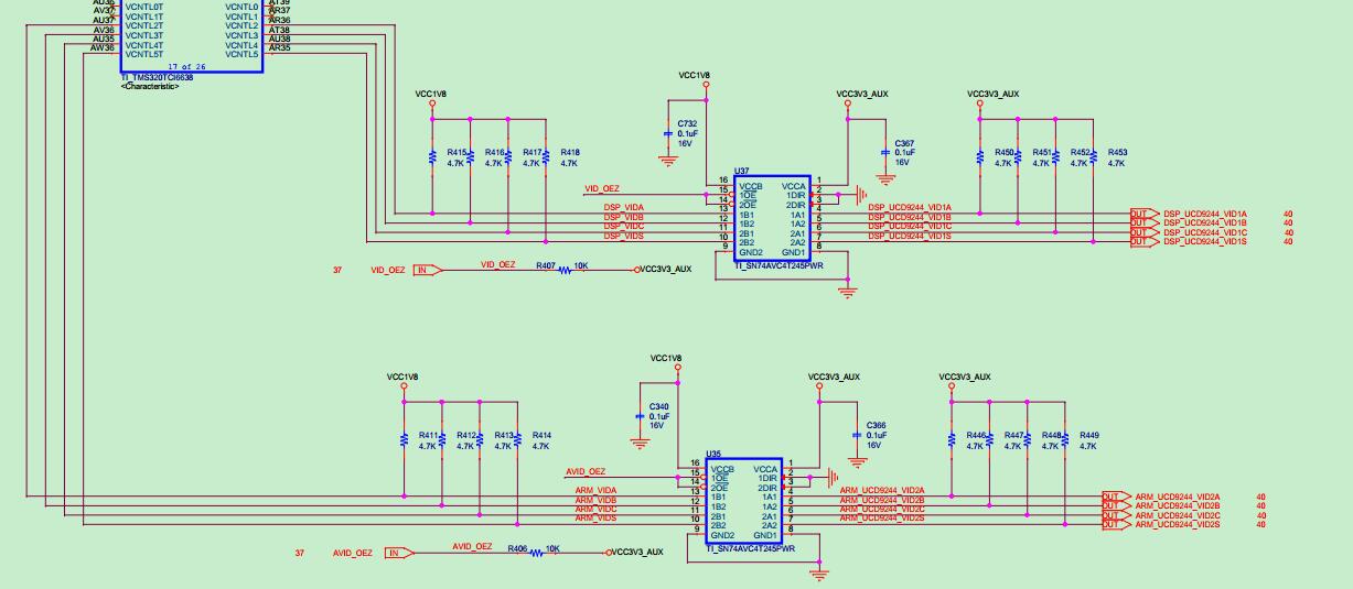

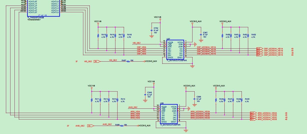

  • Hi Bill,
    One more question.
    In EVMK2H schematics, there are two VID control signals. I think that one is for DSP scaled core CVDD and the other is for ARM scaled core CVDDT.
    But in the lastest 66AK2H14's datasheet, the Pin VCNTL2T(AU37), VCNTL3T(AV36), VCNTL4(AU35) and VCNTL5T(AW36) are reserved.
    Does this mean that the 66AK2H14's ARM samrtreflex is not supported at this time?
    Feng
  • Hi Feng,
    That is correct. Since the CVDD and CVDDT voltages have been combined into a single CVDD rail, only one control interface was needed. The second interface is not supported.
    You should also note that the data manual still includes the CVDD1 and CVDDT1 memory array voltage rails which are both 0.95V. On the EVM, these are driven by separate power supplies but they can be driven by the same fixed 0.95V power supply in customer designs.
    Bill

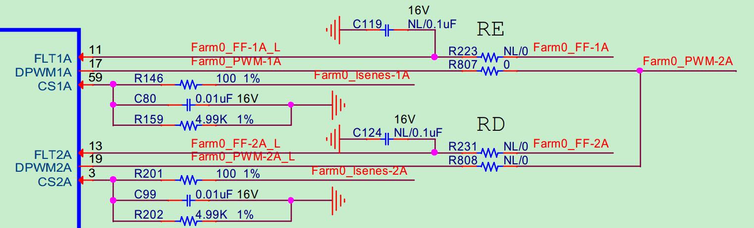

    In EVMK2H's schematics, one UCD9244's channel 1A outputs one PWM signal that is Farm0_PWM-1A to controller two UCD74120s that are combined together to supply for CVDD. The signal Farm0_PWM-2A is not used really.
    And this UCD9244's channel 2A is reserved for ARM smartreflex. This UCD9244's channel 2A just monitors the voltage proportional to one UCD74120(part U44)'s output current.
    But as we discuss above, the ARM's smartreflex is not supported at this moment. So I want to modify channel 2A's signals to support another UCD chip.
    So my new question is,
    How can I use one UCD9244's channel signal CS1A to monitor the current summary of two UCD74120s(as showing in the EVMK2H's schematics, one is part U10 and the other is part U44)?
    As I did before when using UCD9222 to control two UCD7242s, the UCD7242's IMON pin outputs the current proportional to the actual load current and I just combined two UCD7242's IMON pins and connected them to one UCD9222's channel signal CS1A as the UD7242's datasheet shows.
    But the UCD74120's IMON outputs the voltage proportional to the load current. So I can not just combine these two IMON pin together.
    So do I need one voltage addr?? Could you give me advice to deal with the this situation using the simplest way?
    Or the IMON function is not imperative to generate the CVDD power supply and it is just a optional function to see how much the current load will actually be.
    So can I ignore these two IMON pins?
    Feng
  • Hi Feng,
    You are attempting to copy the EVM design as a power supply solution for the K2H component. Due to the changes in the power strategy I've described in earlier posts, that power supply design may not be the best implementation for you. The first step for determining the best design is to populate the power consumption model with your expected needs. You may discover that your current needs for CVDD do not exceed the 25A that can be sourced by a single UCD74120. If you do need more than the 25A provided by that part I strongly urge you to consider a different solution. Attached is a presentation from the power supply group describing analog controller solutions for the K2H using the LM10011 for AVS control. After you have completed the power consumption model, you may find one of these solutions to be a better fit for your design.
    Bill
