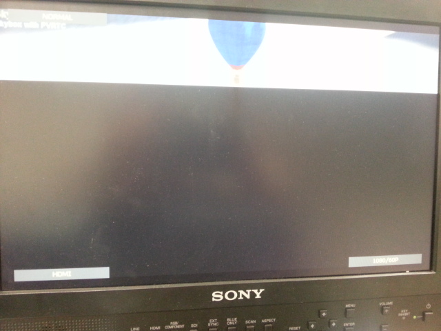

I am running the graphics SDK with DM8148 EVM board, but I see the graphics only in top quarter of the screen. Does anyone have any idea what might cause this behavior ?

When tried to change load.sh script as following
old:
insmod ./kermod/vpss.ko i2c_mode=1 mode=hdmi:1080p-60 clksrc=dvo2:hdmi sbufaddr=${HDVPSS_SHARED_MEM}
new:
insmod ./kermod/vpss.ko i2c_mode=1 mode=hdmi:720p-60 clksrc=dvo2:hdmi sbufaddr=${HDVPSS_SHARED_MEM}
I than get half of screen filled up, but still not full screen.
Thank you very much for any idea,
Ran
