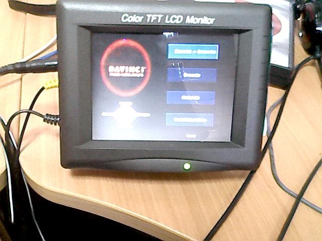

Hello All,
I have dm6446 dvevm and CCS v3.3, i downloaded loopback test from this page http://c6000.spectrumdigital.com/davincievm/revf but there is code only for NTSC. LCD monitor can work only with PAL, how need i change the code for PAL video? Or LCD monitor can work with NTSC?

  • Hello, Sivaraj,
    It help when i used demo:
    when i used NTSC mode (S10 off) grayscale image which is above than must

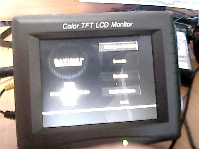

    when i turn on S10 i have
    after i try to run loopback test, s10 still on, but i get video stream like for NTSC:
    how can i get result similar PAL mode demo?
