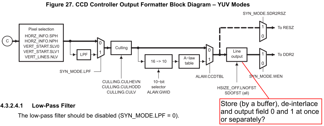

What exactly does VPFE work for BT.656 stream? VPFE has a SDOFST register which can be conveniently configured to do the de-interlacing, but what is its internal mechanism?
( page 55, SPRU977a)
According to Figure 27. CCD Controller Output Formatter Block Diagram – YUV Modes, Line output is the last stage in the pipeline. Does VPFE
  1. has an internal buffer so that it first store field 0 and 1 and then do the de-interlacing all within itself, and only output the restored whole frame in one action (DMA-DDR2 burst) to DDR2?
  2. or does it output each field separately? If this is true
  3. 1)   Does it output each line separately?
    2)   Or does it has an internal buffer to store all lines within in a field first and then output them separetely?
    3)   I don't think in 2) outputting a whole field as an integral block directly to DDR2 is possible. This is due to the interlacing nature of BT.656 such that field 0 and 1 has one line's shift between corresponding lines, so any attempt to write a field as a whole block will overwrite most of the contents of another field.

    2. For the second major question of this thread that whether CCDC two fields of a BT.656 frame separately or combined, I did an experiment and found that CCDC in fact do sends them separately. This is done by:
    1. In the ISR of VDINT0, read FLDSTAT.
    2. Depending on whether FLDSTAT is 0 or 1, change SDR_ADDR to address 1 or address 2 (two arbitrarily selected non-overlapping addresses)
    If we set VPBE's reading address to be either of the aforementioned address 1 or address 2, in both cases we will see only half (all the odd lines or all the even lines) of the alternating lines has valid output and another half of the alternating lines are black. We could conclude from this observation that CCDC do not combine fields before sending to DDR2 but actually sends them separately.
