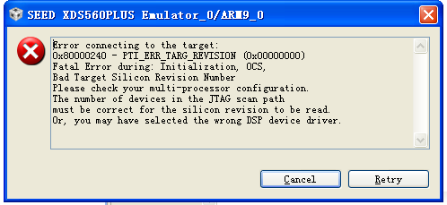

I made my own board based on OMAP-L138.
The version of my CCS is CCSv4.1.2.
And my JTAG emulator is SEED-XDS560PLUS.
When it connects to OMAP-L138’s  ARM9 core,the following error would occur :

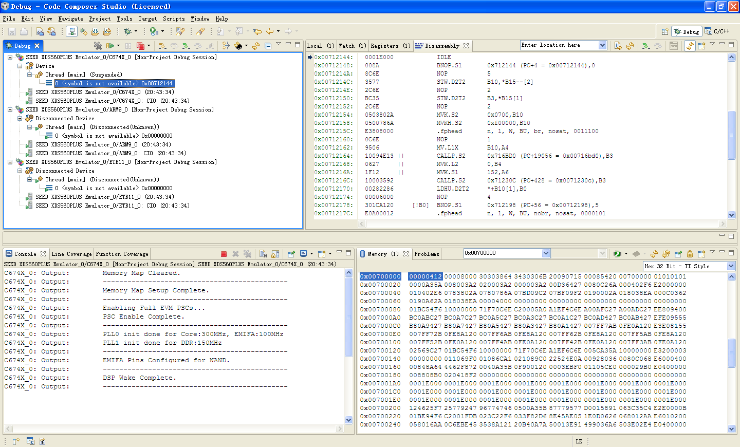

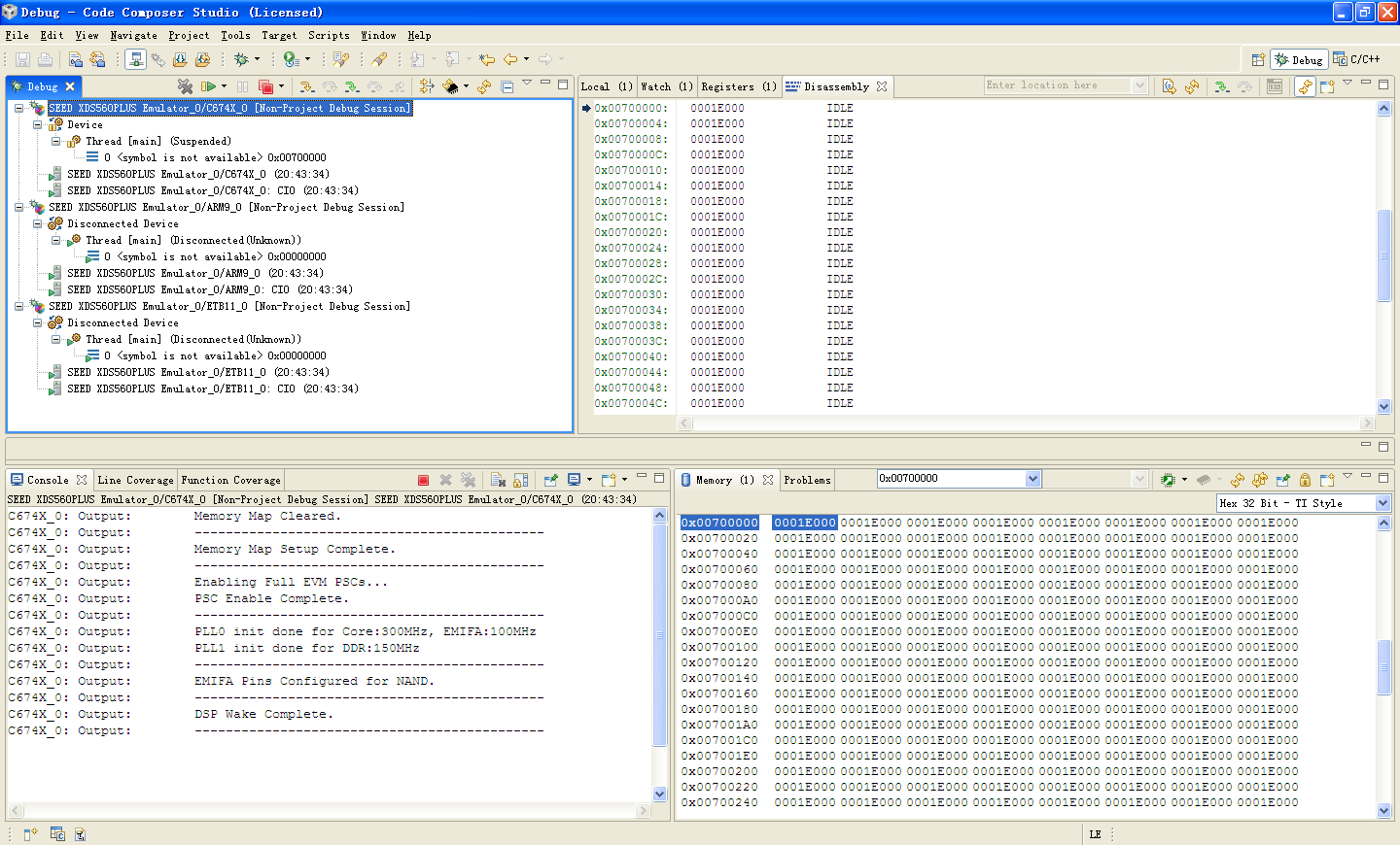

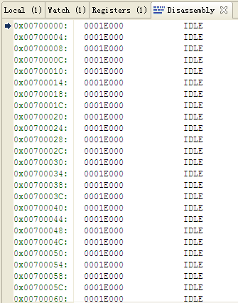

And it could connect to OMAP-L138’s C674x core ,but the codes in DSP L2 ROM are all IDLEs,which means there's no fixed bootloader codes in it :
The power and clock and reset signals are correct. And my CCS and emulator work well with other OMAP-L138 boards.
So does my OMAP-L138 chip get damaged? Could anyone help me?
  • Hi Cicy,
    Please make sure that ou have the appropriate drivers for the SEED emulator, and also check your hardware connections.
    There are several forum posts with the same error for different emulators (search for error in the forums). Take a look and check if any of the problem identified could be what is happening to you:
    http://e2e.ti.com/support/dsp/tms320c5000_power-efficient_dsps/f/109/t/31971.aspx
    http://e2e.ti.com/support/development_tools/code_composer_studio/f/81/t/127572.aspx
    http://e2e.ti.com/support/development_tools/code_composer_studio/f/81/t/92608.aspx
  • Hi Mariana,
    Thanks a million for your response.But actually,I've already scanned such posts and almost all other similar posts several days ago.And I've tried all the suggestions mentioned in them.However,my problem still exists.
    The power and clock and reset signals are correct. And my CCS and emulator work well with another same board.
    So do you think I need to change another OMAP-L138 chip?
    Best regards,Cicy
  • Hi Cicy
    Let us use this post for further clarifications on your issue, you should not have to post the same set of responses on the other thread. The DSP ROM is not visible from ARM side at location 0x007xxx , if you want to read the DSP ROM content from ARM9, please use address location 0x117xxx in CCS memory window from ARM side (you can refer to the memory map table int he OMAPL138 datasheet to understand this concept).
    Please provide a printout from the debug gel file
    http://processors.wiki.ti.com/index.php/OMAP-L1x_Debug_Gel_Files
    Additionally as Rahul mentioned in the other thread, are you making sure that the DSP clocks are enabled via GEL file or other mechanism, as by default DSP is clocked off in OMAPL138. If you are successfully able to do that on the other board, please share the steps on how you go about doing this.
    Finally, do you have local field support for this issue, who could possibly help more efficiently if you think this is a device/board problem.

    Thank you so much for your reply. First, I could only connect to DSP core successfully right now. So the DSP ROM IDLEs are read from the C6748 side exactly. And some hardware tests even have been passed from the DSP core, such as DDR2,NAND Flash, UART,LCD and so on. But when it connects to the ARM core, the fatal error described in the first picture above would appear.
    Second, here’s the printout from the debug gel file:

    Good board: after connecting, the PC located at 0x00712144, and there are bootloader codes in the DSP ROM
    Bad board: after connecting, the PC located at 0x00700000, and there are only IDLEs in the DSP ROM

  • According to debug gel printout, PSC0 Information shows ”ARM  STATE = 0”.So I guess the ARM core wasn’t woken up.
    Therefore, I loaded a dsp gel file “OMAPL138_DSP.gel” and used it to wake ARM. Then it connected to ARM9_0 successfully.
    My steps in detail:
    l       Set the boot mode of my board as Emulation Debug Mode.
    l       Set the target configuration correctly. Make sure select “OMAPL138_ARM.gel” in “initialization script” for ARM9_0 and “OMAPL138_DSP.gel” for C674x_0.Also make sure set JTAG TCLK Frequency as 10.368MHz limit.Then save it as “OMAPL138.ccxml”.
    l       Launch OMAPL138.ccxml. Connect to DSP first of all.
    l       Go to Scripts→Wake Core→Wake_ARM.
    l       Connect to ARM and there’s no error shows againO(∩_∩)O~.
