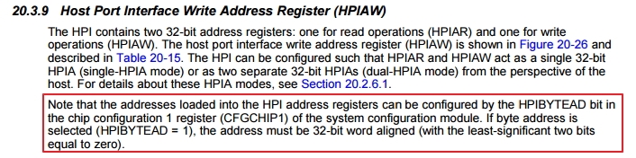

2. Configure 2 pins in  CFGCHIP1
    If I am using 16-bit wide HPI address, it looks like HPIBYTEAD should be set to 0, correct?

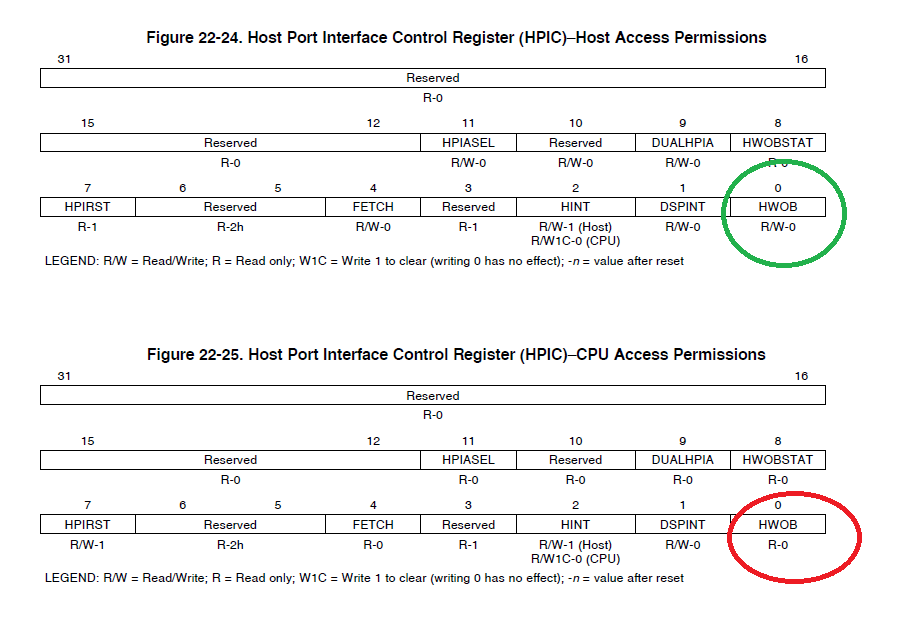

3. HPIC - when I bring up the DSP side of OMAP under Code Composer Studio (6.1.1), I can view HPIC under HPI0DSP, but I cannot change any bits. Is there something blocking me from setting HWOB for instance from the CCS Debug view?
    You can't write HWOB bit as it needs to control by external host.
    Which device you have connected in HPI ?
    Here, you can see, only HOST can control the HWOB bit.

  • Hi Sir
    After setting HPIBYTEAD  as 1 , this issue is fixed
    for your information.
    BR
    Yimin
