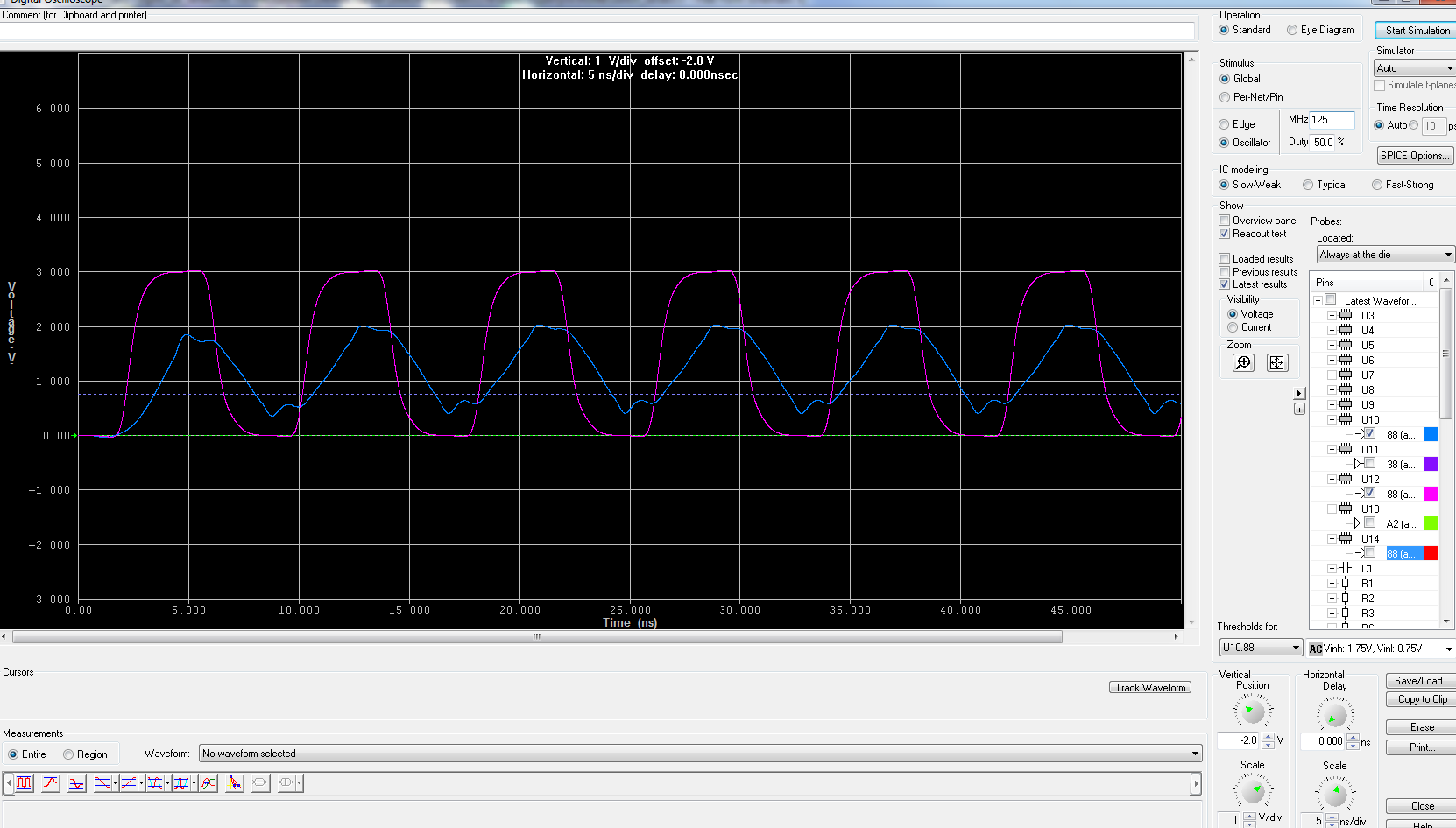

    the problem that I have now is that when I make hyperlynx simulation between the Mac and the TLK1211 it is fine but when I simulate from TLK1211 to the MAC it is not ok, there is anything wrong with the IBIS model of the TLK1211?

    What kind of issues do you have in your simulation?

    1.- I attached a file with the simulation, but according the MAC, the rise and fall time has to be max. 750 pseconds
    blue line- TLK1211
    pink line- other serializer  with good levels.

    1. Could you try with IBIS file of TLK1221 only to double check if the IBIS model of TLK1211 doesn´t have any issue.

    1.- Still it is not perfect but I can see a big difference, typical simulation is OK for TLK1221.
