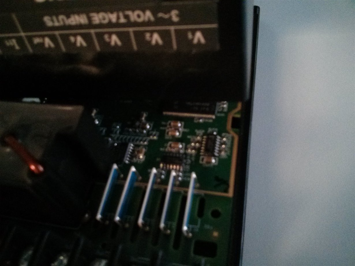

  • 1) We used high voltage resistors that were 5Meg as is common on other commercial meters such as Schneider Electric. These HV resisters will help
    us pass the UL over voltage test which is around 3100V peak.
    2) Yes, we did compensate as per the original post to keep the ratio the same. Do you have more info of how to rebalance the filter?
    3) For meters with user interfaces, UL requires 2 levels of protection to the user from the mains. One is provided by isolation on the
    user interfaces ie Ethernet, RS485. The other is to put "Impedance"  resistors before the burden resistor. If you were to open up a commercial meter such as the Schneider Electric 7650 meter you will see the resistors including the Neutral resistor on the Vref line. See attached pictures. Do you know how to compensate for the offset it creates?
  • The Schneider ION7650 is a panel mounted power quality meter. I don't know the details of this particular unit, but these typically have an electronics core powered by an isolated power supply, and high impedance paths to sense the three phase voltages, the neutral, and possibly the earth, with reference to the ground voltage of the electronics. I see 5 high voltage resistors in the picture of the 7650, so I assume it is measuring the earth voltage. I think it will be using 5 ADCs, concurrently sampling these 5 signals. The exact phase voltages can be worked out, by subtracting the neutral to electronics ground voltage from the 3 measured phase to electronics ground voltages.
    The TI EVM does not measure the the neutral to electronics ground voltage. It is build around the electronics ground being bonded to the neutral, so the three measured phase to electronics ground voltages are the same as the three phase to ground voltages. This is how most utility energy meters are built, including the UL approved ones for the US market which I have seen. If the 7th ADC of the MSP430 is not being used to measure the neutral current it could be used to measure the neutral to electronics ground voltage, and achieve the effect you are looking for.
