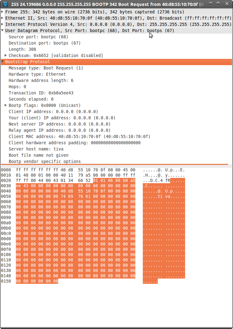

Hi Amit:
I've tried using LMFlash. This didn't work either. I saw some documentation about it, saying that it sends magic packets to the Tiva when connecting. I don't believe the ROM_;UpdateEMAC function is expecting to receive these, as it starts sending BOOTP requests as soon as my code on the Tiva branches to it.
Here's a screen shot of the BOOTP request coming from the Tiva:
And here's the reply coming from our BOOTP server:
I compared the request and reply parameters and they seem to be okay. Wireshark doesn't complain about either packet. I'm trying to assign IP address 10.0.0.1 to the Tiva, but I've also tried to assign an IP address in the same subnet with the same disappointing result; the Tiva never adopts the given IP address.
I looked at the source code for TI's boot loader and I see that it expects to receive a BOOTP reply with the same transaction ID and MAC address as contained in the request packet. These are the same in my response, as you can see above. Of course there might not be any correlation between the boot loader source code and the ROM_UpdateEMAC function; I don't know.
I'm wondering whether the ROM function really does have to be called when the lwIP stack is in use, for some reason. As I mentioned earlier, we're using NDK.
-- Mike
