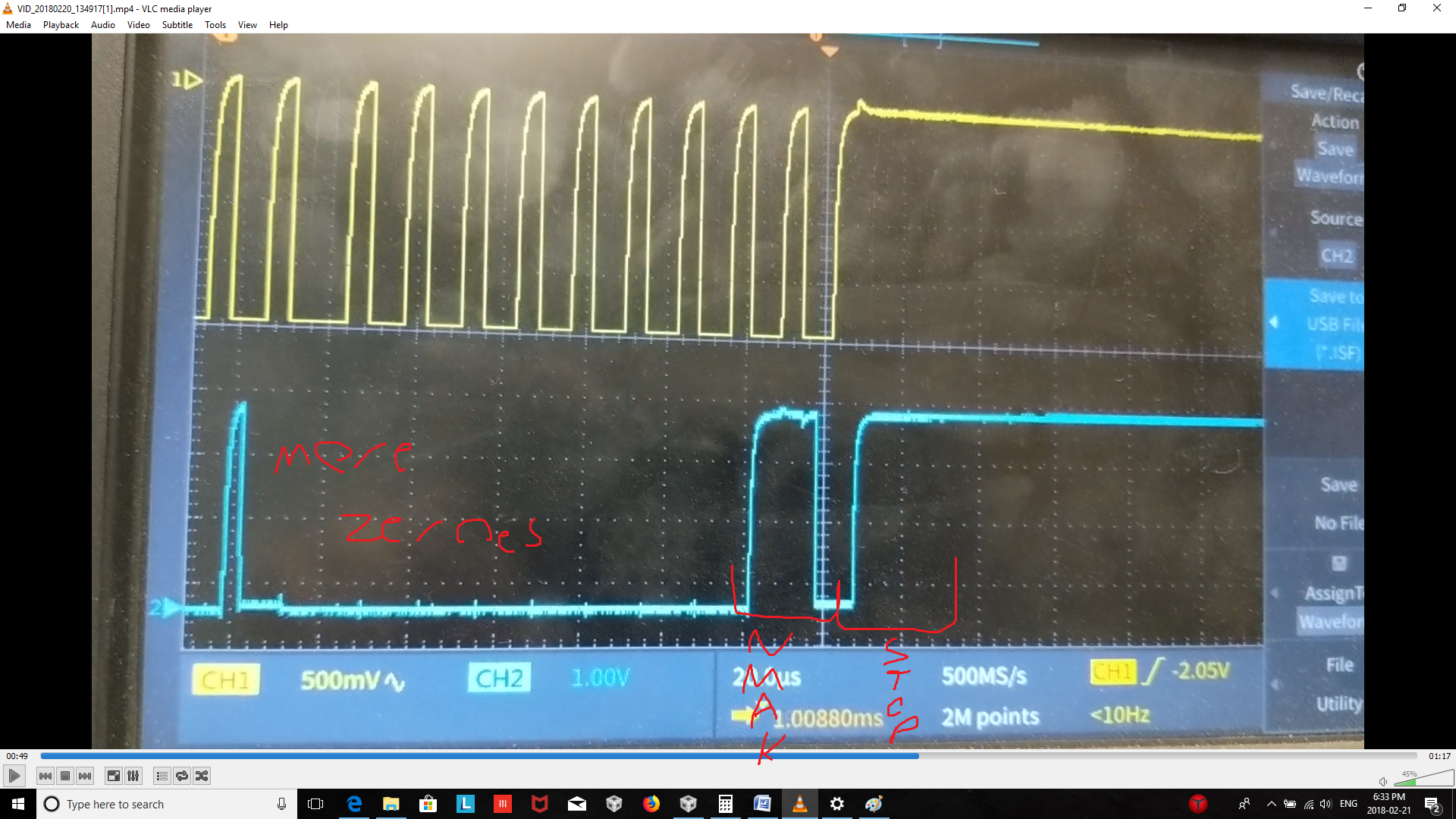

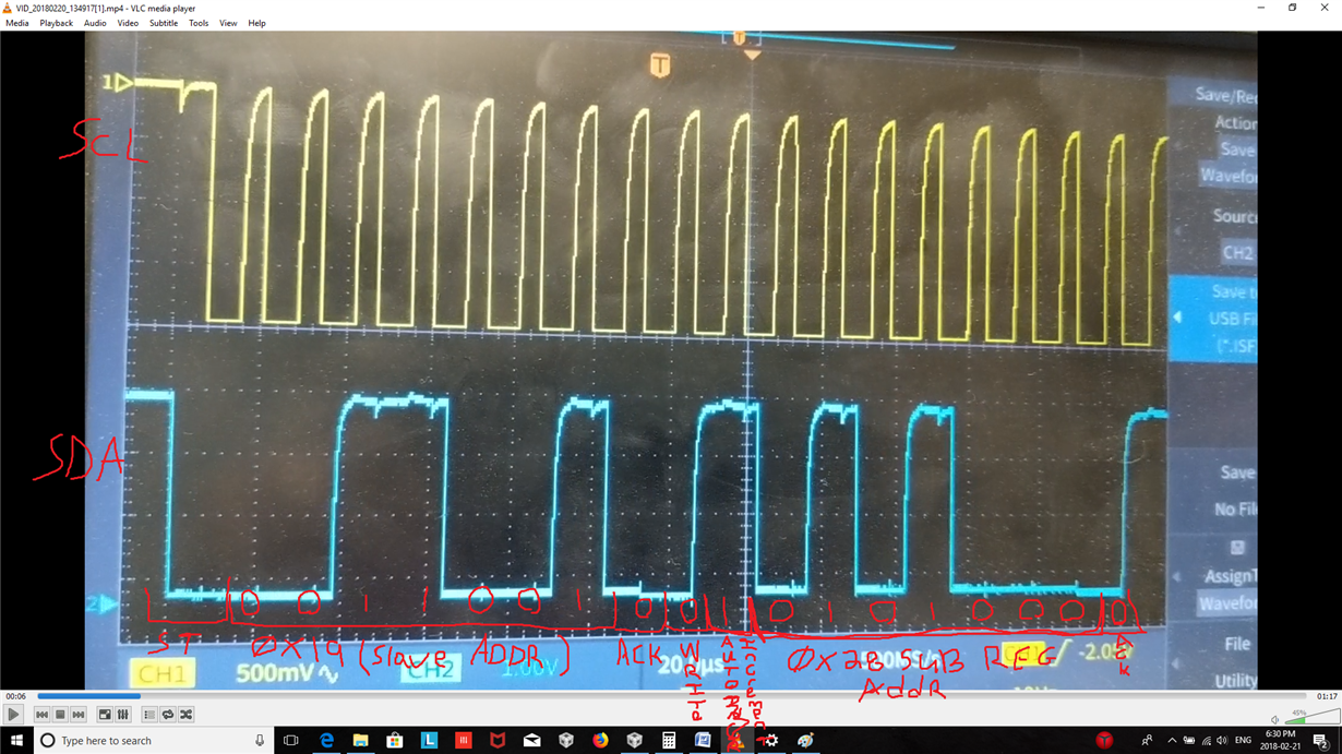

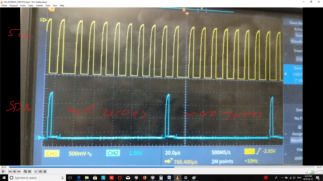

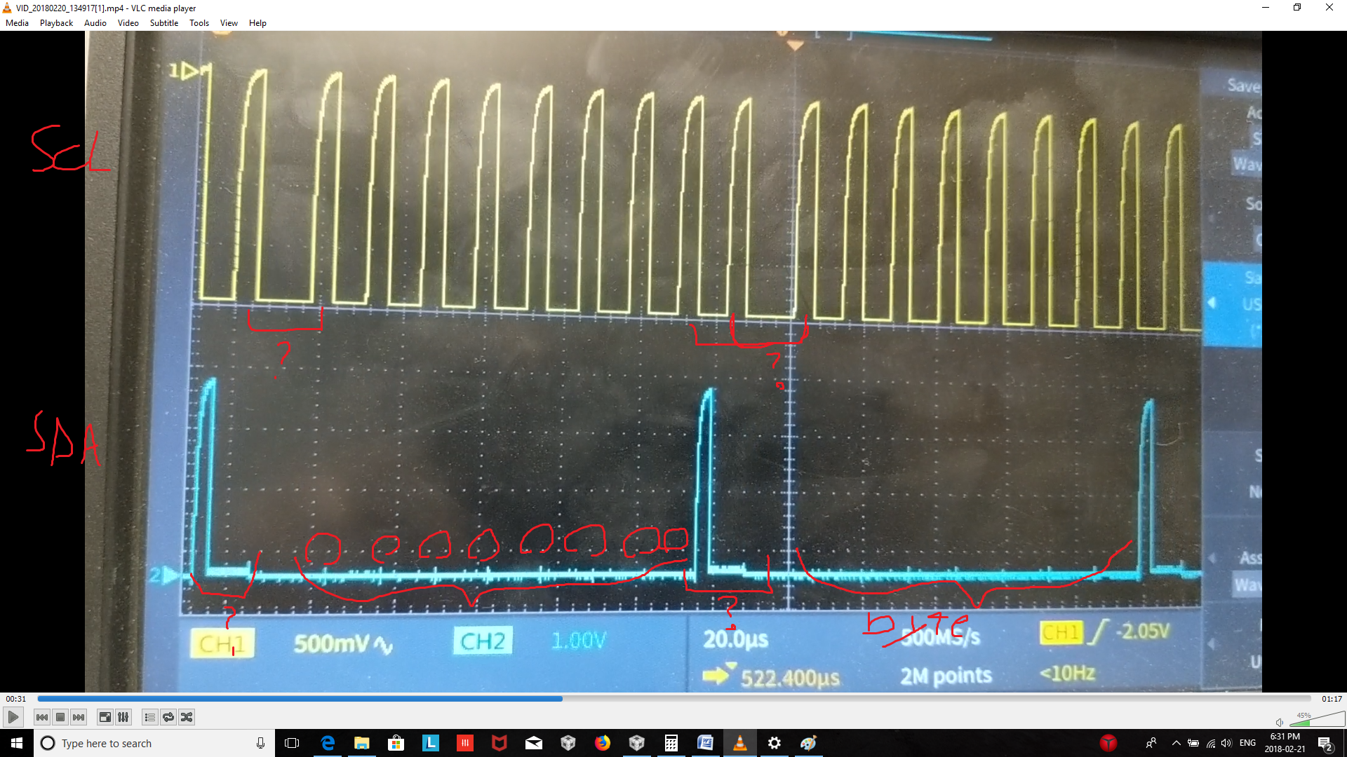

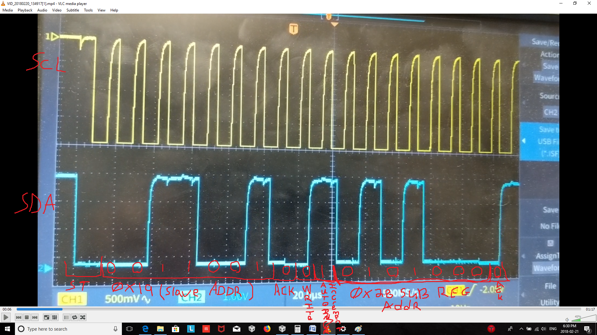

Josh Ingham said:it seems that I am able to communicate with the sensor using I2C. When it comes to reading xyz values I just get zero values.
