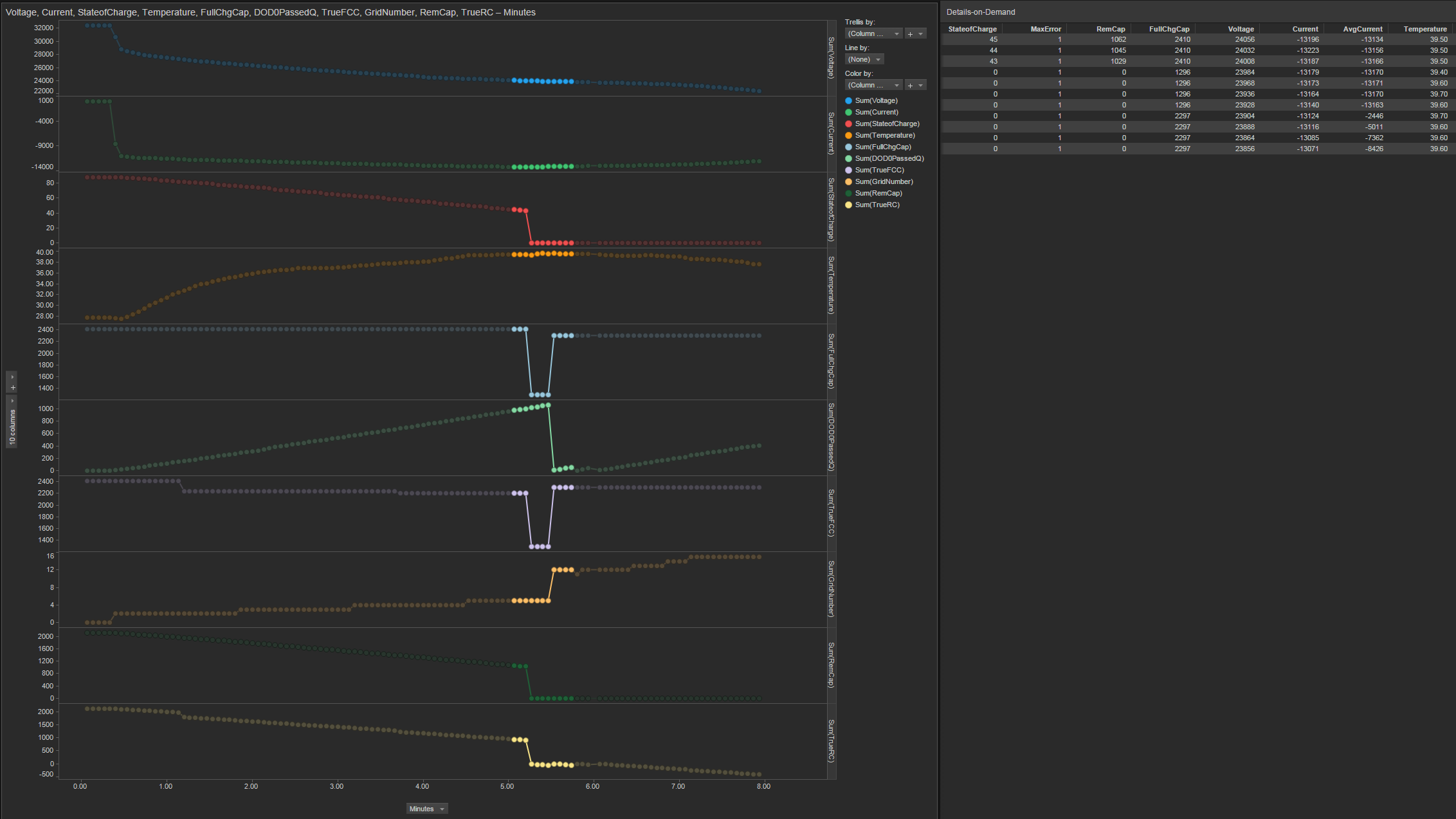

        I used the BQ34Z100-G1 to measure the 8S1P PACK, I  made ten  prototypes, the most of  which are  OK, but two of them are bad. the bad prototypes shows the phenomenon  that  the SOC drop about 40% to 0% in an instant. Pls refer to the attachment and picture. I program the same SREC profile. and calibration the voltage  ,current follow the procedure. Can you help me to solve the problem~ Thanks

    Thank you for the log.  Did you use the GPCCHEM tool to determine a matched chemID for the cells, program them chemID to the gauge, then run a learning cycle to learn the pack?  If not, this will cause the issue seen above.
    If the problem persists after performing the above steps, please also send your gg.csv file that includes your gauge settings, and let me know which chemID you're using.

  • Hi Bill,
    With a partial log its difficult to tell, however, It appears that the terminate voltage of the cell may be incorrect.
    What is the terminate voltage of the cell listed in the datasheet?  The default value of 3000 mV is being used.
    When terminate voltage is reached (3000 mv * 8 = 24000 mV), SOC drops to 0% because terminate voltage is defined as 0% SOC.  At this point Rempcap is set to 0 and FCC is recalculated.  As shown below, the device keeps discharging and the passedQ continues to increment. Another simulation is run, remcap and SOC remain 0 because the gauge is below terminate voltage and FCC is recalculated.
    Please modify the value of Terminate voltage to match that of the cell and rerun the test.
    If this does not help, please modify the Average I last Load to 13000 mAh and rerun the test, or change load select to 6 and set User-Rate MaH to 13000.

  • Dear Bryan:
    Thanks for your reply. I am sorry to tell you it's hard to for me to modify the terminate voltage because the product is hard to disassemble
    In my application, there are two load mode, one is high loading that is about 13000mAh, and the other mode is 5000mAh, in the 13000mAh loading mode it take 9 minutes that more than 500s, but it will be less than 500s in abnormal situation such as this faulty machine. can i run the 5000mAh loading mode to update the Average I last load to solve the issue? Look forward to your reply, Thanks~
  • Hi Bill,
    Please modify the Average I Last Load in dataflash to the expected load for the test. If the 5000 mAh loading mode is run before the 13000 loading mode, Average I Last Load should update to ~5000 mA prior to the 13000 mA test. This may improve results, but may still result in a SOC drop.
    Sincerely,
    Bryan Kahler
  • Dear Bryan:
    Thanks for your support! I modify the Average I last Load to 13000mAh , it's OK!

  • Hi Bill,
    The last load at 13000 mA did not last for at least 530 s, the required time for to be a qualified discharge that will update Average I last load. Since the Average I last load was not updated for this higher rate, the last qualified discharge set the Average I last load, a much lower rate. The calculation was based off the lower rate. Updating for the higher rate allows the calculation to be based off of the higher rate.
