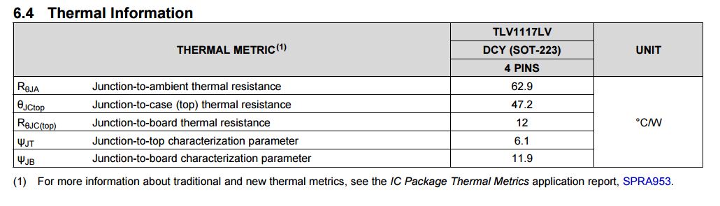

TLV1117LV33DCY Thermal performance
Customer want to know thermal performance of TLV1117LV33DCY.
If there is not heat Evaluation data,Customer can not be employed.
Could you show me the attachment graph of TLV1117LV33DCY?
Customer use heatsink size isPower Dissipation vs Heatsink Aria.pptx15mm x 15mm,6layers.
