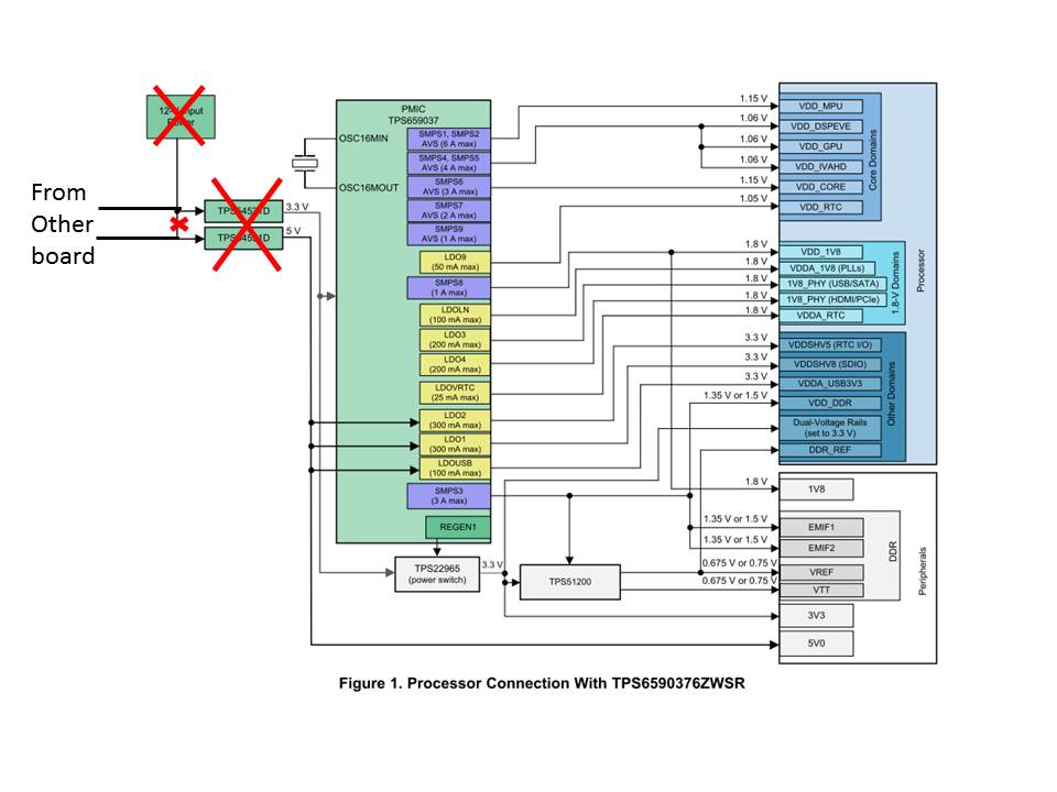

My customer measured the power consumption of 659037PMIC with AM5728.
The combination is the below.
・ AM5728AABCXA(Rev1.1)+TPS659037A383( for Rev1.1)
・ AM5728BABCXA(Rev2.0) +TPS659037A394( for Rev2.0)​
Ver.2.0

My question is below.
1) How do you think regarding this result? Is this result correct?  I think this result is correct. Because, as you know, the booting voltage of AM5728 rev2.0 is higher than AM5728 Rev1.1 device. So PMIC default voltage is changed.
2) My customer would like to measure the maximum power consumption of 3.3V input voltage of PMIC. How does he measure it?  If customer would like to know the power onsumption of 3.3V input voltage of PMIC, the below voltage setting should be used?
VD_CORE =VD_MPU = 1.2V
VD_RTC=Other =1.16V

    > On Q2 , please clarify what you meant by "maximum power consumption of 3.3V input voltage of PMIC. How does he measure it?"
    --- Please see the below figure. This is my customer's connection.
    As you see from the above figure, 3.3V and 5V for PMIC is supplied from other board.  So customer would like to know the maximum current that is consumed by PMIC.
    But we don't know how 3.3V power source is consumed internal PMIC circuit. So customer would like to know the PMIC's worst case that 3.3V source is consumed.
    I appreciate your quick reply.
    Michi

  • Hello Yama-san,
    There are two sources of internal power consumed by the PMIC. The first is the quiescent current of the PMIC. This is specified in the datasheet per rail, meaning each SMPS and LDO has a quiescent current spec. You can add these up for all rails that are used in your system.
    The second part is efficiency loss of the SMPS and LDOs. To calculate this, you will need to know the load current, input voltage, and output voltage of the regulators. Then you can use the efficiency to calculate power loss. We have an Excel tool that will make this easier.
    e2e.ti.com/.../3366.power-estimator-tool
    Karl
