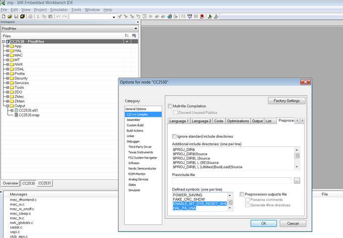

       I'd like to build a CC2530ZNP image that is just like the one used here; compatible with HA1.2. Which compile flags are used to enable HA1.2 compatibility?
    Derek

  • Derek,
    -Install Z-Stack ™ HA 1.2.1 http://www.ti.com/tool/z-stack..  In case Z-Stack ™ HA 1.2.1 is installed at the default path, open znp.eww using IAR (8051).
    -For IAR Project CC2530-ProdHex, go to options->C/C++Compiler->Preprocessor->Defined symbols' and define ENABLE_MT_SYS_RESET_SHUTDOWN.  Build and flash .
    Built image is compatible with Z-Stack Linux gateway
    Saurabh

  • CC2531 alone as a coordinator seem not have enough strong signal for home with thick wall etc. I need CC2531+CC2591. Can I had a Coordinator firmware for this Home Gateway which had PA_LNA enable where CC2531+CC2591 is used? Thanks.
  • Hi, bump the question again. Is it possible to get coordinator firmware which is for CC2531+PA_LNA to increase the signal? Thanks.
    Btw, why private message is not working anymore atm?
  • You can try to build it by yourself. Try to enable HAL_PA_LNA in ZNP project.
  • ZNP project from Z-Stack Home 1.2.1 can use with beaglebone linux gateway? I'll try.
  • It should work with linux gateway.
  • Hi ,
    To make HA 1.2.1 ZNP image work with Gateway , do the following :
    - Open ZNP project workspace in IAR 8051 - C:\Texas Instruments\Z-Stack Home 1.2.1\Projects\zstack\ZNP\CC253x\znp.eww
    - Since you need to enable CC2531 + PA LNA , For IAR Project CC2531-ProdHex  , define compiler option ENABLE_MT_SYS_RESET_SHUTDOWN  (for Gateway ) and HAL_PA_LNA ( in case of CC2591 front end) and compile
    - Connect CC Debugger to CC2531 and flash C:\Texas Instruments\Z-Stack Home 1.2.1\Projects\zstack\ZNP\CC253x\dev\CC2531ZNP-Prod.hex
    Saurabh
  • Hi Saurabh,
    I have a custom board with CC2538 as ZNP device. What all changes do i need to make in Z-Stack Home 1.2.1 CC2538ZNP source code inorder to make CC2538ZNP work with linux gateway.
    i am getting following errors when i compile with ENABLE_MT_SYS_RESET_SHUTDOWN
    Error[Pe020]: identifier "STIF" is undefined C:\Users\VVDN123\Desktop\Z-StackHome1.2.1\Components\mt\MT_SYS.c 1686
    Error[Pe020]: identifier "SLEEPCMD" is undefined C:\Users\VVDN123\Desktop\Z-StackHome1.2.1\Components\mt\MT_SYS.c 1695
    Error[Pe020]: identifier "PMODE" is undefined C:\Users\VVDN123\Desktop\Z-StackHome1.2.1\Components\mt\MT_SYS.c 1695
    Error[Pe020]: identifier "PCON" is undefined C:\Users\VVDN123\Desktop\Z-StackHome1.2.1\Components\mt\MT_SYS.c 1701
    Error[Pe020]: identifier "halSleepPconValue" is undefined C:\Users\VVDN123\Desktop\Z-StackHome1.2.1\Components\mt\MT_SYS.c 1701
    Error while running C/C++ Compiler
  • I did follow your guide without PA_LNA enable. Select CC2531 - ProdHex.
    Not change the default, just add ENABLE_MT_SYS_RESET_SHUTDOWN into compile option. This all the compile option now:
    FEATURE_SYSTEM_STATS
    CC2531ZNP
    POWER_SAVING
    ASSERT_RESET
    FAKE_CRC_SHDW
    Now flash the files which is in:
    Projects\zstack\ZNP\CC253x\CC2531-ProdHex\Exe\CC2531.hex
    into CC2531. This one is normal TI CC2531 without PA-LNA.
    Plug into beaglebone black. check lsusb, no dongle detected. Linux Gateway not working.
    Tested given CC2531-GW-ZNP_38724.hex working with no issue.
    Can you share the .hex file? With & without PA-LNA for CC2531 that work with Beaglebone Black Linux Gateway?
    Thank you.
  • Any recommendation of CC2531 with antenna(without PA-LNA)? Need one that had cert such as FCC/CE.
    You are not flashing correct binary . You need to flash C:\Texas Instruments\Z-Stack Home 1.2.1\Projects\zstack\ZNP\CC253x\dev\CC2531ZNP-Prod.hex
    Saurabh
  • After compile, there is no 'dev' folder available. There is existing 'bin' and new folder 'CC2531-ProdHex'.
