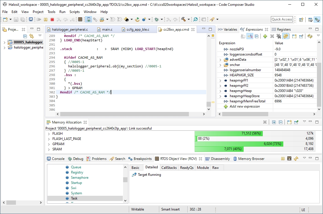

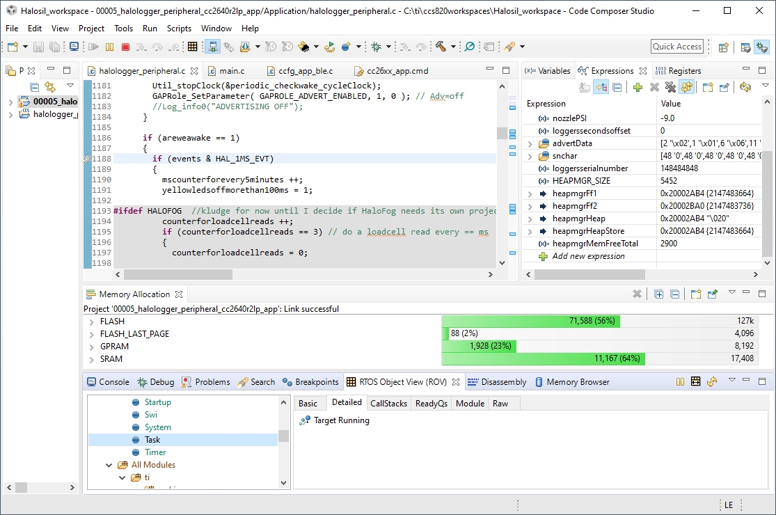

    I was able to add HEAPMGR_METRICS and the values can be seen here:
    Unfortunately when I break the running code, I can not use ROV>Task>Detailed view to investigate stack usage.  My forum topic on that issue has not been answered yet cc2640r2f-received-exception-from-rov-server.
    Dale
  • So:
    1. How do we properly move sectorbytes16x256[] to CACHE RAM?
    I have figured out the syntax for the .cmd line that was needed to move sectorbytes16x256[] to CACHE RAM.
    We have LOTS of FREE RAM available now and we advertise but we still are not able to achieve notifying on 4 characteristics at the same time Disappointed
    Here is the code and memory status's with the code advertising:
    Still no joy, perhaps I should start a separate topic about not being able to achieve notifying on 4 characteristics at the same time since this topic has been resolved as far as advertising goes...
    Dale
    PS: It looks like the proper LINKER define should be 'CACHE_AS_RAM=1' as per this doc cache-gpram (but I seem to get the same results if simply 'CACHE_AS_RAM' is define in LINKER)
