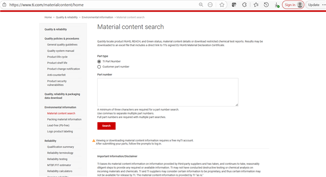

Hi Board designers,
Inputs regarding weight and material content
https://www.ti.com/materialcontent/home
Sreenivasa
