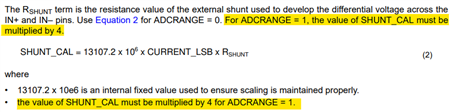

Hi, I have issue reading current back from INA229 EVM. I am using it in ADC range =1 mode and calculating current shunt based on the following equation: SHUNT_CAL = 13107.2 x 10^6 x CURRENT_LSB x RSHUNT. But the current measurement is 4 times more than the actual value. Is the internal fixed value on the equation (13107.2 x 10^6 ) only for ADC range=0 or for both ranges? There is no information about this on the datasheet.
