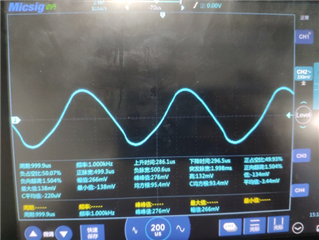

Please provide the schematic for the OPA541 circuit. The report says "the circuit mode is simple and forward input, the ratio is 1 to 4." Does that mean it has a gain of 4 V/V?
Additionally, I am having difficulty determining the output voltage swing from the O-scope images. What are the volts/div settings for the O-scope? If the output is only swinging a few hundred millivolts it may be crossover distortion. Is the output waveform initially undistorted, and then becomes distorted as the OPA541 heats? I see the heatsink in the images. Is there a theta, heat-sink-to ambient rating for it?

①Circuit diagram:
②The voltage/div setting of oscilloscope, each grid of y-axis is 100mV
③Whether it is a fever problem:
A: the distortion waveform exists at the beginning. When the input voltage is 100mV, the amplitude attenuation is caused by the resistance voltage in front of opa541. After the four times gain amplification of opa541, the peak value of the output is 278 MV, and the current is not large. The temperature of the device is room temperature by hand. It is normal, and there is no high temperature phenomenon. When the frequency is adjusted to 10Hz, the distortion will not be obvious. The larger the frequency is, the more obvious the distortion is.

All of this information supports my original thought that the distortion is what is commonly known as crossover distortion. The OPA541 uses a class AB output stage to conserve operating current when it is not driving a heavy current load. The transistors in the output stage nearly turn off when the output voltage is near 0 V. What is actually being observed is the output transistor base-emitter voltage characteristics as one output transistor hands off the load current to the other output transistor. One sinks current and the other sources current. The region where the transistors are nearly turned off is highly non-linear and that is where the distortion comes from.
Normally applied negative feedback reduces crossover distortion. Therefore, the lower the closed-loop gain (Acl) the circuit operates with, the lower the crossover distortion will be at a particular frequency. Because the op amp's open-loop gain (Aol) increases as frequency is lowered, the loop gain (Aol - Acl) increases and the distortion decreases with it. That is why you are observing a reduction in the distortion as the frequency becomes lower.
A gain of + 4 V/V is not an unreasonable Acl for the OPA541 to be operated at with a 1 kHz input frequency. Unfortunately, crossover distortion is an inherent characteristic of a power op amp class-AB output stage such as that used by the OPA541. There isn't anything we can do to the op amp itself to eliminate this type of distortion. However, there may be some things that would decrease it somewhat:

I suppose the term "high current" is relative. Certainly when the output current is in the hundreds of milliamperes or Amperes, we refer to them as high current op amps. This distinguishes them from the more precision op amps where the output current is typically 50 mA and less.
Do note that the power op amps such as the OPA541 are most often applied with a wide output voltage swing. Many times the swing approaches their maximum in relation to the supply rails. In such cases the crossover region is a smaller portion of the output range than it is in your application where the output is only swinging about +/-400 mV.
Regarding the OPA541 a 2 Ohm, or 0.5 Ohm load is a high current load if the output voltage is such that a high current flows. For the OPA541 that would be Amperes of current.
2.if it meets the high current load, that is, the load resistance is less than 2Ω in the experiment, will its output stage still be class AB, that is, will the distortion change?
Most often for class-AB output stages the crossover distortion increases with an increase in load current. That is because the change in transistor current that when operating within the crossover region to when it is driving an increasingly higher current is a more radical change compared to when the load current is much lower.

There is one other technique that is sometimes applied to op amps to reduce crossover distortion, but it is at the expense of increased power dissipation in the circuit. The technique forces the op amp output stage to operate class-A and eliminates crossover distortion. The basic idea is to add a load to the op amp output that forces it to continually sink, or source current. I have seen this applied to low power op amps, and should be applicable to high power op amps but in the latter case the power dissipation might be a problem.
I found an online article that discusses moving an op amp's output to class-A operation. I think it discusses the concept well:
https://tangentsoft.net/audio/opamp-bias.html#
I expect this could be accomplished by adding a resistor from the OPA541 output pin to the VEE supply. A 150 Ohm (2 W min) resistor would add about 100 mA current load to the OPA541 when the output is +400 mV peak. You might want to give this a try and see if the crossover distortion improves for you circuit.
If the output voltage is made higher (more positive) the resistor current and power will increase in accordance with Ohm's law and the Power law so keep that in mind.
