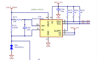

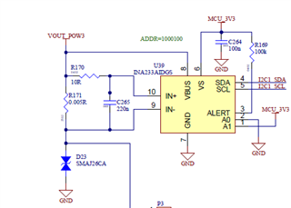

    There is no schematic difference, e.g CH 4 & CH3:

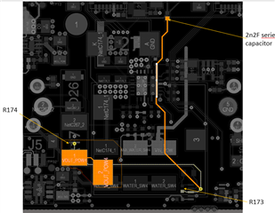

  • But there is a difference  about layout :
    CH4 : U40, R173 in BOTTOM  & R174 in TOP + Nets of IN+ & IN- are routed TOP and Bottom
    CH3 : U39, R171 & R170 are placed in TOP + Nets of IN+ & IN- are routed TOP and Bottom

    So it makes sense that offset got worse when shorting R173. The reason is because input filter offset (due to the R174) is going to be negative because the IN+ input bias current (IBP) can be negative (going out of IN+ pin) when VCM = 0V. All it takes is IBP = -2µA, in order to generate a delta of -4mA of input offset.
    What does not make sense is how the offset is already so high with channel 4. There are definitely some things that can be improved with the layout of input traces for both channels shown and you can refer to my modified layout example from datasheet. Overall, it is best practice to route the traces through the pads of the 220nF input capacitor (i.e., C267, C265). In your current layout the input traces go directly to the input pin and not through the capacitor pads.
    The layout suggestion above doesn’t seem to be the real root cause here, but I though I would mention anyway. However, there seems to be a trace from the shunt-side of the 10-Ω (i.e., R173 for ch4 and R170 for ch3) that goes outside of the image. Where do these traces go? See the below images with the trace marked with green markup.

  • Hi Peter,
    This trace is for a "Power Line Communication" :  the data is phase modulated by a sine wave at a predefined carrier frequency -@10,4MhZ).
    e.g : PLC output : C is 2n2F in our schematic
    I did test without C (2n2F) and with the PLC component in a RESET mode, but the offset current measured doesn't change.
