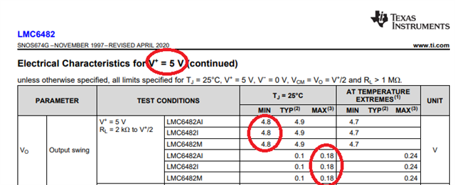

We have fund a issue when using the LMC6482 as the current sensing amplifier, with single supply(0 - 5V), and input common voltage is very close to ground. the offset is around 20mV (with 10V/V, the output is around 200mV), but this spec is not specified in the datasheet. we have only define the offset when the common voltage in the middle of supply.

    The 20mV "offset" you refer to is NOT a true offset voltage but rather a byproduct of the non-linearity of the output stage. Even though LMC6482 is called rail-to-rail input/output and the input common-mode voltage range of LMC6482 is true rail-to-rail, no linear op amp can swing all the way to its rails at its output as this would require no current in the output stage. If you look at the output range of LMC6482, it is specified around 200mV from either rail - see below.  Thus, if you drive the output to zero, the closest it can get to ground is 180mV, which in the gain of 10 will show as 18mV "offset." In reality, it is simply a voltage 1/10 voltage divider of the output voltage minimum swing.
