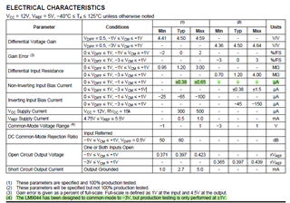

As our customer indicated that sometimes O2 sensor gives output less than 0 volts in case if gets contaminated.
And Vdiff is always mentioned as 0 to 1V in datasheet. if Vdiff is less than 0V then the output is always zero as LM9044 is not powered with dual power supply. Please confirm.
The common mode range mentioned for LM9044 is -1V to 1V.
Is below interpretation of common mode voltage is correct?
Case1:
Vin(+) = 1V
Vin(-) = 0V
V.cm = [Vin(+) - Vin(-)]/2 = (1-0)/2 = 0.5
V.diff = Vin(+) - Vin(-) = 1-(0) = 1
Case2:
Vin(+) = 0V
Vin(-) = 1V
V.cm = [Vin(+) - Vin(-)]/2 = (0-1)/2 = -0.5
V.diff = Vin(+) - Vin(-) = 0-1 = -1
    • Yes, the Electrical Characteristics specified VDIFF is 0 ≤ VDIFF ≤ 1V
    Case1:
    Vin(+) = 1V
    Vin(-) = 0V
    • Yes, that is correct
    Case2:
    Vin(+) = 0V
    Vin(-) = 1V
    • Yes, that is correct. Even though the LM9044 has a common-mode range of −3V ≤ VCM ≤ +1V, a +1 V voltage applied to the inverting input would try to drive the output to a negative voltage which can't be done with a single positive supply device. The 0 ≤ VDIFF ≤ 1V range assures that won't happen.
