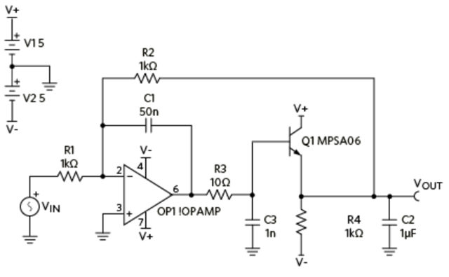

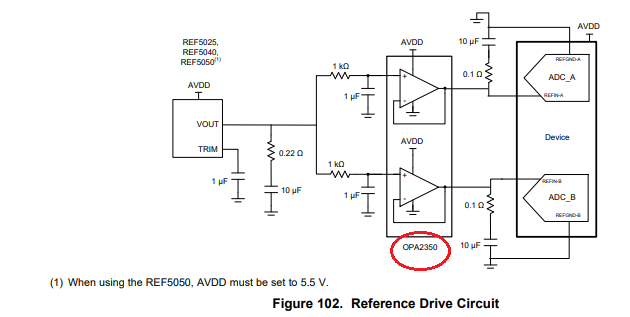

Are there any other known choices I should consider, besides adding additional components? - e.g. like shown below
One of the feature checkboxes in the search function is "High Cload Drive":
ti.com/amplifier-circuit/op-amps/products.html#p480=1;1&p2192=High Cload Drive
One op amp capable of driving directly in a buffer configuration micro-farad loads is OPA350 - see below.
Also, please see link below:
e2e.ti.com/.../opa350-capacitive-loading-with-intent-to-filter
Thanks Marek, OPA350 would be an excellent choice. The only disadvantage: no popular SOT-23/SC-70 packages available.

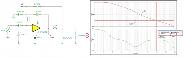

Solution using dual feedback loop is not preferred either - it has to be optimized for constant, know capacitance.
This is less problematic than it sounds and might only be an issue, if the variance of load capacitance is huge. But if you add a dummy load capacitance at the ouput of buffer which is bigger than your varying load capacitance, the dual feedback can work very well. The very most buffers work this way.
Kai
Tomasz,

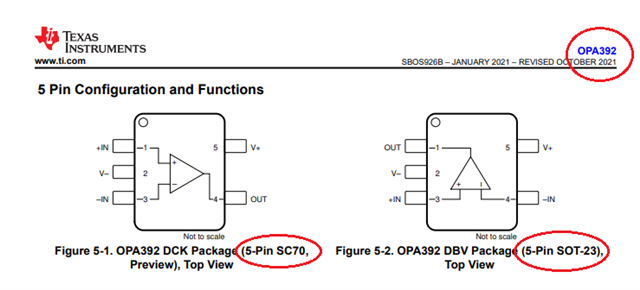

If you absolutely need the SOT-23-5 or SC-70-5 package, our new OPA392 may be your best choice - see below.

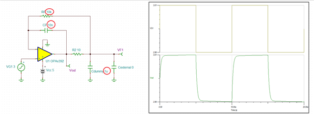

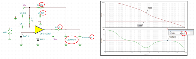

By optimizing the dual feedback compensation for a dummy 1uF cap, as Kai suggested, you will assure stability for any external capacitance, Cexternal, from zero to 1uF - see below.
Cexternal = 0
Transient small-signal simulation confirms stable operation - see below
Cexternal = 1nF

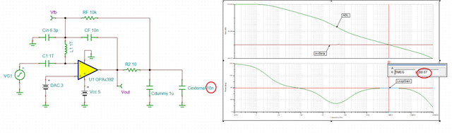

Cexternal = 10nF
Cexternal = 100nF

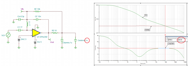

Cexternal = 1uF
Below I have attached Tina-TI schematics for your convenience.
