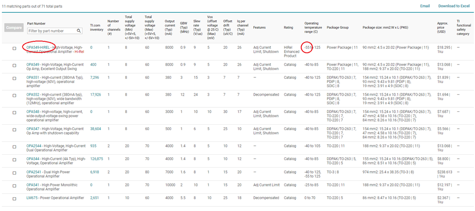

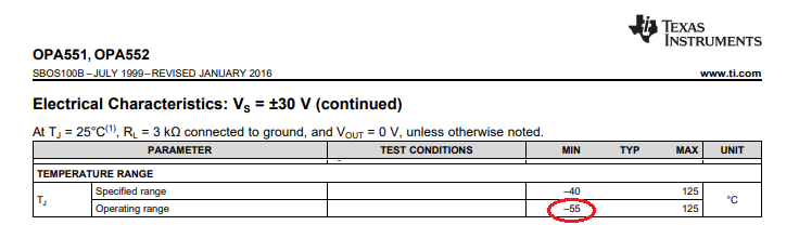

A standard industrial temperature range is specified from -40ºC to 125ºC and for -55ºC you would have to use a military, or high reliability products. having said that, OPA551/OPA552 do work down to -55ºC (see below) but some of the maximum specifications like input offset voltage or drift may not be met.
If you absolutely need a specified temperature range down to -55ºC, the only part to meet this requirement would be OPA549-HIREL - see comparison table below:

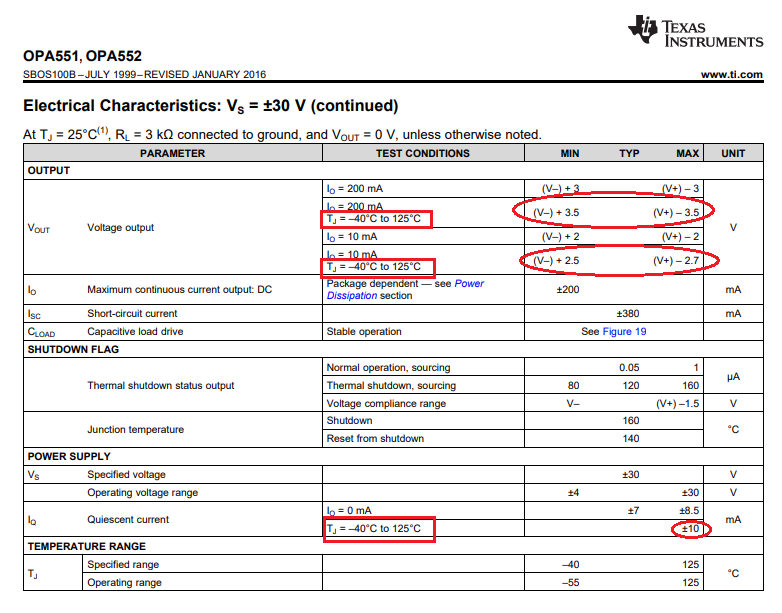

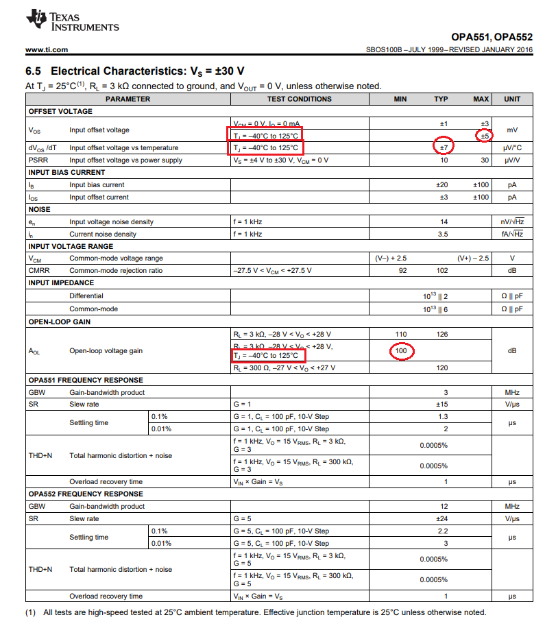

The OPA551 specs that may not be met at -55ºC are simply those that are specified in datasheet only for Tj from -40ºC to 125ºC - see below.
However, if the OPA551FAKTWTG3 is meant to work under -55ºC ambient temperature on +/-12V power supplies or higher, there may be no reason to be concerned because in such case under quiescent condition (no load) and with SOIC package junction-to-ambient thermal resistance of 96.7 [ºC/W], the actual junction temperature, Tj, will be above -40ºC due to self-heating; Tj = -55ºC + (24V*7mA)*96.7 [ºC/W] = -55ºC + 16.3ºC = -38.7ºC
All these means that even under -55ºC ambient temperature OPA551 SOIC will meet all of the over temperature specs because its junction temperature,Tj, would stay within the specified range of -40ºC to 125ºC.
