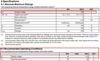

Hi team,
As datasheet description, VCC can support ±6 V to ±75 V.  So Does OPA455 can support asymmetric input? example:V+= 75V and V-= -12V. thx
  • Hi Jimmy,
    yes, of course. But read section 7.3.4 of datasheet and adapt the "absolute maximum ratings" given in section 6.1.
    Kai
  • Hi Jimmy,
    As Kai pointed out, asymmetric supply voltage rails are ok to use.
    For a single supply rail, the recommended max. operating voltage is 2*75 = 150Vdc.
    For dual supply rails, the delta of supply voltage rails of (V+ -  V-) has to be <= 150Vdc.  In your case, you have 75 - (-12) = 87Vdc, which is well within the recommended supply ratings for OPA455 IC. So you are good.
