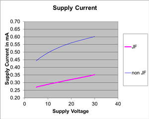

The JF typically has lower supply current and less phase margin in some unity gain circuits.

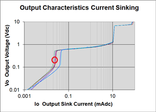

  • Shinichi,
    There is no JF data sheet. It has the same specifications as non JF
    In 2006, I personally noticed lower supply current (temperature was 0C)
    JF was less current for low VOL range, curves in red circle. LM2904B is even higher low VOH current (not on this chart) The jump up occurs further to the right

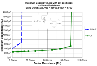

    J oscillated with less direct output capacitance more series resistance was needed to make that stop

    I'd like to confirm about sink current VOH.
    I understand Red circle has 4 line for JF.
    On the other hand, are lines of navy blue and blue for non JF?
    Also, could you please suggest each of Vcc voltage.(Could you please see attached figure)

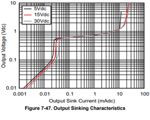

  • Hi Ron,
    This is a Figure Output Sinking Characteristics of LM2904.
    It is described each of Vcc.
    Shinichi
  • Shinichi-san,
    Ron is out of office for this week, and will return on the 21st of March.
    In the mean time I can do my best to answer your questions. I'm not certain what the supply voltage was of the tested units. I'm assuming the blue and navy blue lines are both channels of a non-JF device. The multiple lines in the red circles are probably multiple JF devices tested. However I would expect the JF device to shift across supply voltage similarly to the non-JF devices.
    Jerry
  • Hi Jerry,
    Thank you for your reply.
    I understand supply voltage is uncertain and blue and navy blue line is probably non JF.
