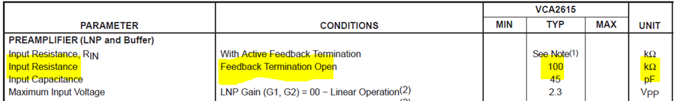

    Hi all
    I use VCA2615 in ultrasonic application.
    On the page 18 of Data Sheet
    Table 5. shows codes for Feedback Resistor Settings.
    I have come across that setting any code other than
    '1111' (Open) causes a significant increase in noise.
    For example, for code = '1111', input termination Rl=0, amplifier gain = 52dB
    (about 16dB for LNA with a single ended input plus 36dB for VCA)

    Please answer two questions:
    1) Why is this happening?
    2) What is FEEDBACK RESISTOR for code '1111' (Open) ?
    Please also refer to the datasheet page 17,
    it mentions in the open position, the input resistance of the LNP is about 100kohm.

  • Hi Viktor,
    Thanks for sharing the details. I understood the problem.
    So, when you set FB1-4 as '1111', essentially meaning open; the input resistance (Rin) will be 100 kohm as shown in the datasheet.
    Also, note that the Rin is the input resistance and with active termination, Rin is a function of feedback resistor and LNP Gain.

  • Hi Victor,
    Apologies that I missed this message. I had replied quite a while back and seems like somehow my reply didn't went through earlier.
    I calculated the Rin for 18dB (similar to yours at 22dB). That's all.
    For an amplifier say non inverting, you have noise figure (F) = 1 + NA/NI; where NA is the amplifier noise and NI is the contribution due to source and the termination. The noise figure is just noise factor in logarithmic scale.
    So for an amplifier where you are giving input to the positive terminal with source impedance Rs, termination resistance Rt, you will have
    NI = 4kTRs  x (Rt/(Rt+Rs))^2
    If you have Rt - infinity i.e open then you will have NI = 4kTRs
    when Rt = Rs then NI = kTRs
    Hence, without termination you will find the lower noise figure. But the signal integrity will be compromised and you will see very poor system performance.
    It goes to the transmission line fundamentals, if you don't match the impedance, you see a lot of reflections which in turn will degrade performance.
    So, this answers the need of termination.
    The active termination provides lower noise performance as compared to conventional termination. This is discussed in detail in the datasheet.
    So, you are correct that it is impossible to get less noise than for
    FB4,FB3,FB2,FB1=1111 (Rin=100 KOhm).
    2) The 8 curves are just shown for comparison between the active termination and standard termination case especially highlighting that active termination is better in terms of achieving lower noise. The 8 curves just represent the different LNP noise as representation numbers, for eg if LNP noise is 0.6 nV/rtHz, how does the NF varies with source impedance. They are not device numbers, just representational numbers that's all. The actual device data is provided in the specification table.
    3) Figure 21 shows the variation of NF with Vctrl and it has smallest value at max gain as shown, but with Rs = 0; Figure 61 does not show any value at Rs = 0. The LNA Gain is 2 dB different and VGA noise also may be different.
