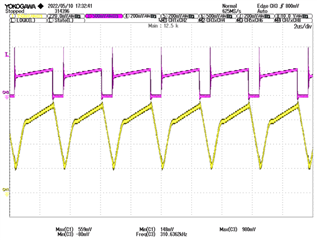

Measure the signal by oscillator, can found the outputpin1 of U19 is different.
Mark :22 C5
Mark :15 TI
CH3: pink U19-pin3
Ch1:Yellow U19-pin1

    Was the voltage table measured with a fixed DC input? The differences are slew rate and the strength of the always on sink driver. Because the load is restive and capacitive, the output current may be greater or lesser than the 'always on' sink driver. Therefore the high power output transistors of the op amp are sinking in the left picture and sourcing in the right picture. This is a natural result of the LM2904 output stage and the application load. As a test, try adding a 1k ohm or less resistor from pin 1 to ground. If I am correct, then 22C5 will now look more like 15TI (22C5 main output transistor will now be sourcing)
    See sections 3.1 and 4.3
    Design Guidelines for Devices with LM324/LM358 Cores

    do not directly touch any pin of OPAmp with the DMM or scope but insert an isolation resistor of >100R first.
    Also, you heavily dynamically overload the LM2904. The 310kHz input signal contains extremely far reaching harmonics and by this you run the LM2904 way beyond its possibilities. You should either low pass filter the input signal and/or take a much faster OPAmp.
    Kai

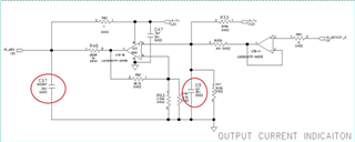

    The table doesn't make sense for DC input. The output should be same as the input unless the output was at it's maximum current. There are two DC loads on the output, 10.5k and 909k. The 10.5k requires 43uA of current from the op amp.  What is the voltage on the other side of the 909k? To get the numbers shown below, it would need to be over 60V (to make op amp sink enough current)
