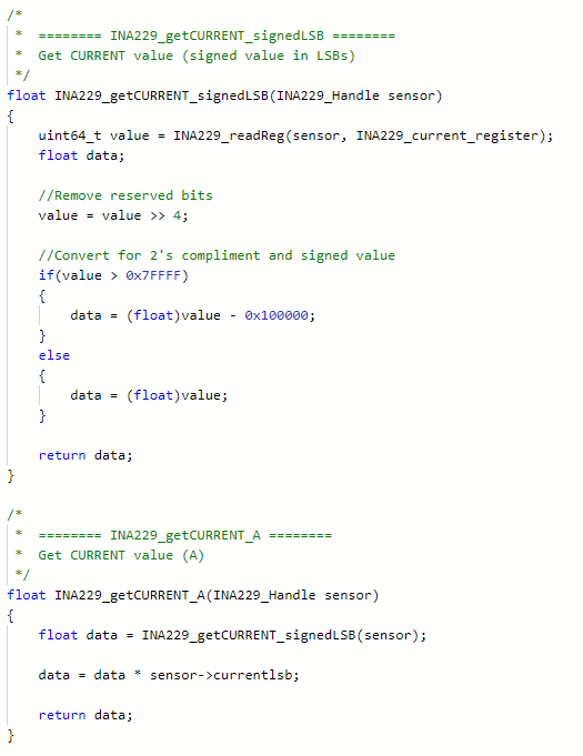

Hi expert,
I would like to confirm with you that if the Current Regisiter reading is 0F FF FC (This is the value that has been shifted right by 4 bits), it corresponds to a large current value or a small current value?Thanks.
