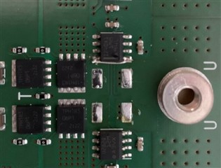

    Also, where is the decoupling cap at pin 5 of INA240? This decoupling cap should sit closest to pin 5 and should also connect to the ground plane.
    Kai
  • Hi Kai,
    thank you for your response.
    We have the board here with a single ground plane (last revision), but the waveform is the same here (at least with no load).
    The digital ground plane is on layer 2, running directly underneath the INA240 pin, it can't be seen in the picture. The vias are connected to this plane.
    I'm not sure what you mean with the decoupling pin at pin 5 (pin 5 is the output pin in the SOIC package). We have 100nF decoupling caps on the supply voltage (pin 6) and voltage reference (pin 3).

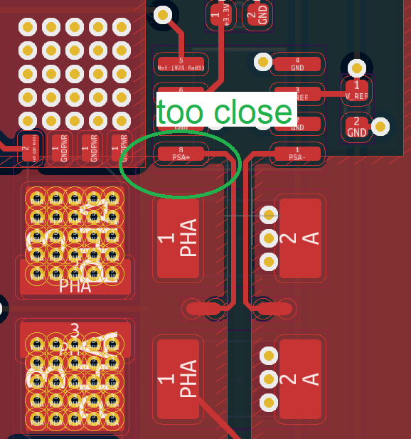

    The way the two inputs are connected to each other (short-circuit) may not be symmetrically enough for the very steep edge and the common mode signal may partially transform into a differential signal at the inputs of INA240.
    I would try to optimize the short-circuit like shown below (by soldering zero Ohm shunts or thick copper wires at the places where the shunts have to be soldered) and would remove the piece of wire between the two inputs:
    Also, even with the original shunts soldered onto the printed circuit board, the upper shunt may be too close to the INA240. The common mode signal may capacitively couple into the both inputs of INA240 unevenly, resulting in a differential input signal, making it for the INA240 impossible to fully remove the common mode input signal.
    So, I would try to move the INA240 a bit away from the two shunts and eventually shield the inputs of INA240 by a piece of ground plane between the shunts and the inputs of INA240:
    Kai
  • Hi Kai,
    thank you very much for your valuable advice regarding the hardware layout.
    We were trying to get the INA240 as close as possible to the shunt resistor, in this case it might be a bit too close then.
    What we are surprised about is that we see this "slow" signal distortion long after the actual switching process. Is this typical for capacitive coupling?
    We will incorporate the suggestions into the next hardware iteration and post the results here.
