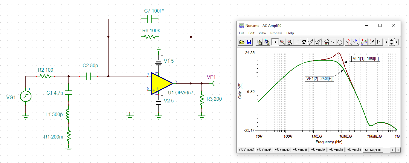

I've both simulated and tested a TIA cuicuit using OPA657. this circuit is made for a 30pF PD
simulated result is here
2layer TIA circuit is made ,layout is close to the evaluation board.   I make a interface circuit (C1=4.7nF,C2=30pF) and use the VNA to test the bandwidth.
VNA results is here(Cf=0.25pF)
if I change Cf to 0.1pF, the bandwidth is 6.38MHz.
 i wonder whats the problem ?
