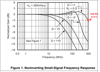

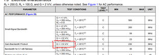

On the OPA656's page, it states:
GBW (typ) (MHz) 230
BW at Acl (MHz) 500
Why BW > GBW? How 500MHz derived here?
Thanks.
The GBW of 230Mhz is valid for higher gain G>10.
For lower gain setting the Bandwidth will be higher because of Gain peaking.
BW at Acl meaning -3dB bandwidth at minimum stable positive gain which is for G=1 in this device.
See the below graph (Figure 1 of Datasheet)
