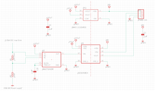

simulation does work.
what do you think about that?

The INA271 can theoretically be floated, but your schematic is unclear about one thing: How is GND2 (or GREF1 in the simulation) connected to the load ground?
You can never violate the following ratings:
1. Voltage from input pins (IN+ and IN-) to device GND (Vcm) must remain >= -16V and <=80V
2. Voltage from supply pin (V+) to device GND (Vs) must remain >= 2.7V and <=16V
In your simulation, V_IN+ is 30kV with respect to load, thus GREF1 must always be <=30.016 kV or >= 29.02 kV.

Hey Daniel,
GND2 I believe should be your high voltage ground according to schematic. Although this means your Vcm is now 30kV which will not work for INA271. If this is case then you would need to put INA271 on the low side (below R4).
Although to better answer your question I will add the expert in isolation to assist.
Overall you still must maintain the following inout pin voltage ratings I described in last post.

Hey Peter,
I have another schematic. GND2 comes only from the DC-DC converter and is not connected to the ground of my high-voltage power supply
Hey Daniel,
Do you know if there is any definitive voltage difference or connection between GND-HV Power Supply (or the 25kV rail) and GND2? This is the crux of issue for INA271. I will defer to the ISO124 expert on the ISO124 schematic and ground connections, but overall, the Vcm of INA271 cannot be violated as I have mentioned. So you need to define what is the voltage difference between IN+ (25kV rail) and GND pin (GND2 net).

Hi Daniel,
The ISO124 will not be able to withstand 30kV for long, only rated for a min of 1.5kVAC. It also required bipolar power supplies on both high and low side which I cannot confirm from your schematic if they are present.
Can you please comment on what is driving the desire for high side current sensing on a 30kV application?
