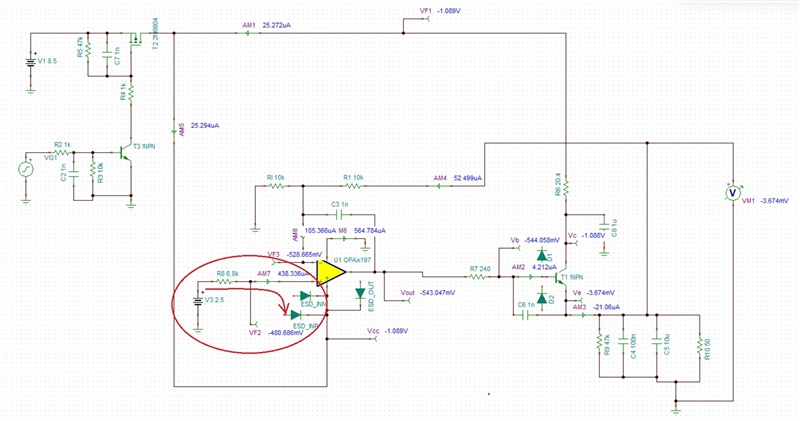

Hello TI,
could you please provide internal circuit block diagram for OPA197-Q1. I want to understand the device output behavior when there is a voltage present at the input pins even though Vcc is not present. Does the output voltage goes to negative ? I have 2.5V with a 6.8Kohm resistor  in series at the non-inverting input and the device is not powered. I have a gain of 2 and i observed an output voltage  of -0.5V in this condition. Could you please explain the reason behind this ?

  • The absolute maximum ratings forbid voltages above (V+) + 0.5 V.
    There are clamping diodes to V+. Larger voltage make a current flow through these diodes into V+, and might partially power up the amplifier or any other device connected to V+. But below 4.5 V, correct operation is not guaranteed.
  • 2.5V input will pulled up Vcc of OPA197 to around 1.8V and in the case of Vss grounded may forward bias Vout ESD diode pulling it down to -0.5V - see below.  This is because in order for OPA197 to bias up properly and be able to deliver current to load, the minimum supply voltage of 4.5V must be met.

  • Manoj,
    You did not provide me with details of your schematic and voltage you measure at different nodes so I can only assume certain things: any voltage drop across Rs is only possible when the current flow thru it - this means that the same current must also flow thru ESD diode. Therefore, voltage drop from 2.5V down to Vss is a sum of voltage drops across Rs and diode.

    Here is the snapshot of TINA simulation file. when T3 base is low, I observe -1V at T1 collector and -0.5V at U1 output. Is this because of the ESD diodes on the output ?

  • Manoj,
    Manoj,
    Because of the large 438uA current thru R8 resistor, a non-inverting input terminal gets pulled down to -480mV turning on ESD diode to positive supply - this results in Vcc at -1.089V (see below).  A negative Vcc forward bias output ESD didoe pulling it down to -543mV.   At the same time Vcc forward-bias parasitic diodes of T1 transistor causing the current flow in opposite than normal direction - see red arrow of the current flow thru ESD and parasitic diodes. The total currents (AM6) of 564uA gets sunk by the negative supply to ground.

  • Manoj,
    With Vcc floating and 2.5V input, OPA197 attempts to properly bias up that requires IQ of ~1mA.  This results in 2.98V drop across 6.8k resistor (480uA*6800ohm) and forward biasing of parasitic ESD_INP diode (additional 0.6V drop) driving Vcc to -1.089V (see current path below).  However, schematic below does NOT account for additional OPA197 internal parasitic junctions, which in actual application may result in different Vcc condition than the simulation below.
    For this reason, you should NEVER allow Vcc to float as this condition may result in damage to IC.  Thus, in order to prevent said condition, you must add on the supply line a Transient Voltage Suppressor (TVS), which in case of Vcc floating will clamp the node a diode below ground preventing any damage to OPA197 - see below.

  • Since there is no charge pump inside OPA197, you are correct that the current should be limited to 368uA (2.5/6.8k).  The negative voltages are the result of difficulties of the simulator to process floating nodes - in order to converge, it makes certain assumptions resulting in negative voltage.  The actual part will not show negative voltages - all voltages will be within applied 0 to 2.5V
